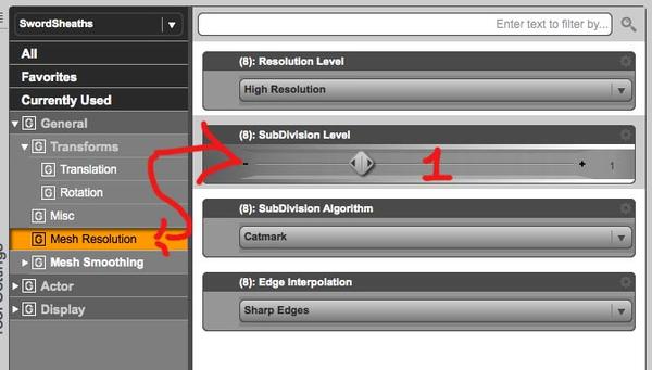

    Its definitely the SubD, With my Wildenlander Pose set I included a wearable preset to load the set with viewport preview SubD set to 1 and the outfit performs well for posing, I included a few other useful presets to compliment this cool set of clothing. The set was quite difficult to work with until I found this setting.
    You can change the setting after loading all of the pieces, select them all in the scene pane and select the Mesh Resolution and change Sub D Level to 1. This should only affect the Sub D level in the preview pane and when you render it will use the full subdivided version.

    Thanks. That did the trick. Even with every element visible the program is reacting with Parameters…General….Mesh Resolution…Subd set to 1. Some items had been set to three. I appreciate the help.
