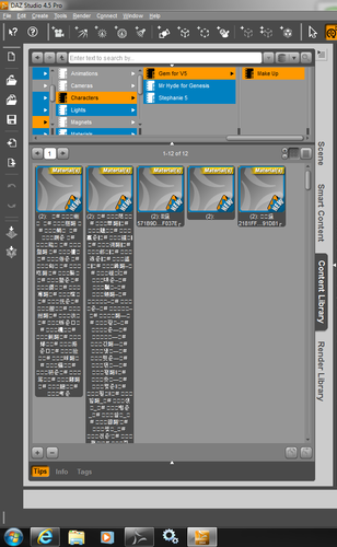

    I'm running Win7 also! I do see the path you mentioned for Vista & Win7. Once I load DS 4.5 & go to Content Library - Categories - I only have 2 Categories showing one is Default the other is My Library. No matter what I do I can't add any categories or access any of my backed up Content Database.
    On my recent install I'm seeing some pretty bizare icon labels. I will atempt to attach the image to this posting!
    665 x 1080 - 99K
