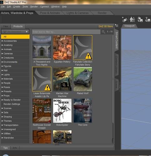

Hi, can anyone help me resolve this issue please? Version 4.7 is unusable for me in SmartContent because it just brings up the same thumbs no matter what folder I try. I can't access the proper thumbs at all. I have tried sending it off to remake its folders index, but that didn't work. Any ideas please? Thanks!

    Hi Cecilia, thanks for that suggestion, I had been a bit nervous of trying that but went ahead - it ran through the whole lot, but now the thumbs are showing just 11 products, but the same problem - same no matter what folder I click to. lol!! I think I have an ornery version or something ... lol! Any other ideas?

    Please post a screenshot of what you are seeing.
  • 3DScreencraft3DScreencraft Posts: 504
    Thanks Richard; first is the larger shot, and then the second shows that if I click on any other folder I only see the same result.

    Try clicking the Files tab instead of the Products tab at the top of the pane.

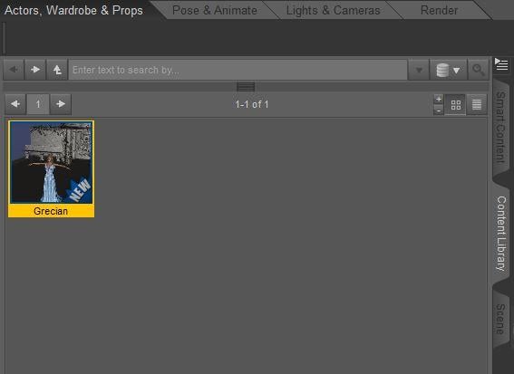

    Also, when I went to the ContentLibrary tab to show you that proper thumbnails were appearing in there, I clicked on the scroll to go backwards and all the folders disappeared! And when I try to navigate using the arrow, to go back up folder by folder, nothing happens. I'm now stuck with no folders. lol! .... okay, which ugly stepmother waved a cracked wand and cursed my DAZ??

  • Richard HaseltineRichard Haseltine Posts: 111,332
    Click the dark button above 1-1 of 1 to reopen the folder list.
    It looks as if the CMS is getting the wrong location - you may need to rset the database as well as reimport metadata.

    Whoo hoo!! Thank you Richard; you were right, I had to reimport metadata and reset the database and now I seem to have it all. Thanks so much! :D
    Oh, and also about getting the folders back in the ContentLibrary. :)
