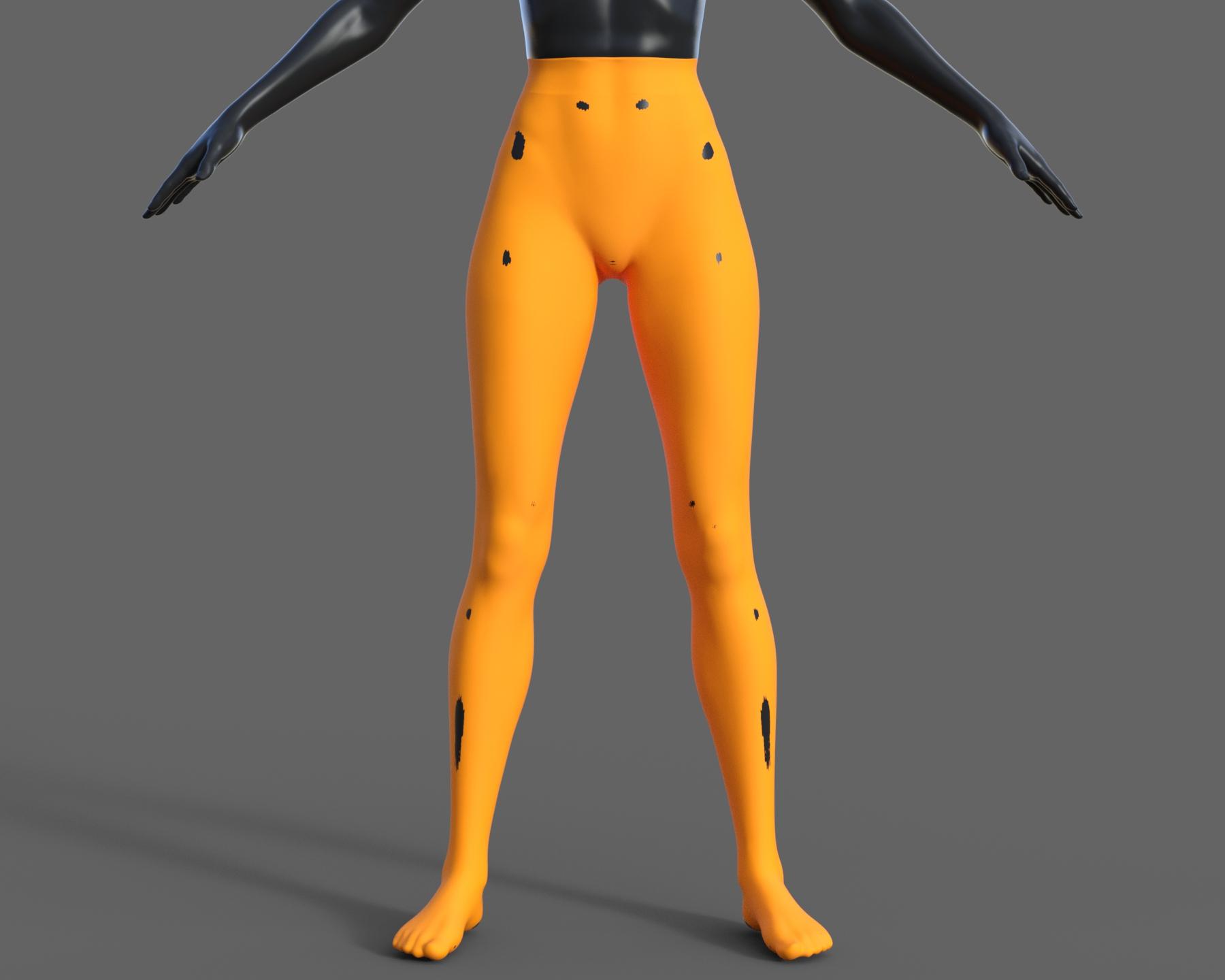

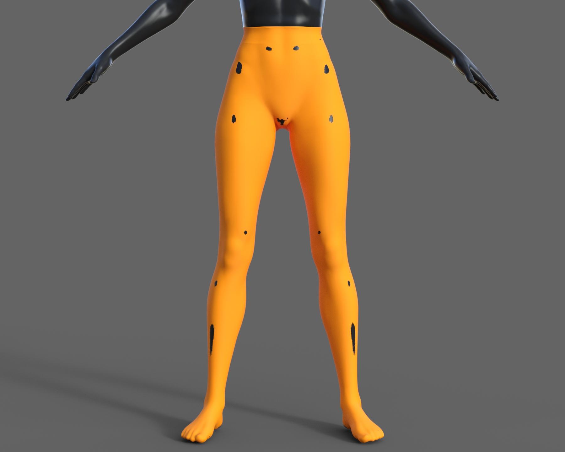

    This was supposed to be a post about how raising "viewport subD level" can help with poke-through. But... Studio doesn't want to play nice today.crying
    What it does show is that the characters "viewport subD level" affects collision.
    In this example negatively.
    The pantyhose settings are the same in all renders. Smoothing iterations is set to 1.
    The character is Sherisa HD. (HD applied with body morph)
    Character "viewport subD level": 1, "render subD level": 3
    Character "viewport subD level": 2, "render subD level": 3
    Character "viewport subD level": 3, "render subD level": 3
    1800 x 1440 - 446K
    1800 x 1440 - 449K
    1800 x 1440 - 450K
    Post edited by blaz on
