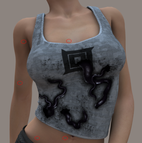

Faint black and white lines in Poser 7 Firefly render
NeyjourNeyjour Posts: 12
edited December 1969 in Poser Discussion
Does anyone know what might be causing this?
Granted, they're barely visible and would be very easy to fix with postwork, but I'd like to get rid of them in the render if possible.

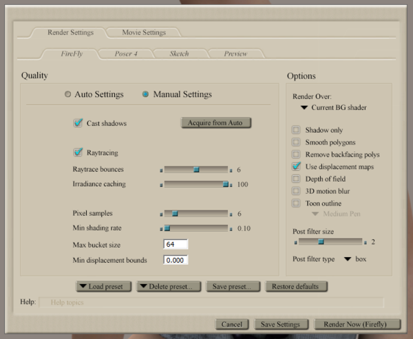

I'm also attaching the render settings.

  • Richard HaseltineRichard Haseltine Posts: 111,363
    You may want to slightly raise the Shadow Bias setting on one or more of your shadow casting lights.
  • NeyjourNeyjour Posts: 12
    edited January 2015
    The lights I'm using are a preset (Image Based Lighting) that came with Poser 7. There are 4 lights and none of them have the shadows toggled on.
    But... I have Ambient Occlusion nodes attached to the skin and clothing. Could that be what's causing it?
    Post edited by Neyjour on
    I'm not sure, it certainly sounds plausible.
  • ConnaticConnatic Posts: 287
    Try entering a non-zero Min Displacement bounds value. Maybe .001 and see what happens.
    Thanks Connatic. I'll give that a try! :)
    I'm fairly certain now that the problem does lie within the render settings. I set up a new scene with a different character (and no AO nodes), different lighting, but the exact same render settings... and I'm still seeing these lines. And they're even more prolific and noticeable on dark textures, so I really do need to fix this... it would be way too much tedious postwork otherwise. :P
    0.001 = no change
    0.01 = no change
    0.1 = success!!!
    Thanks very much Connatic! :)
    I have a suspicion that the degree of ambient occlusion you are using is reacting poorly with displacement.
