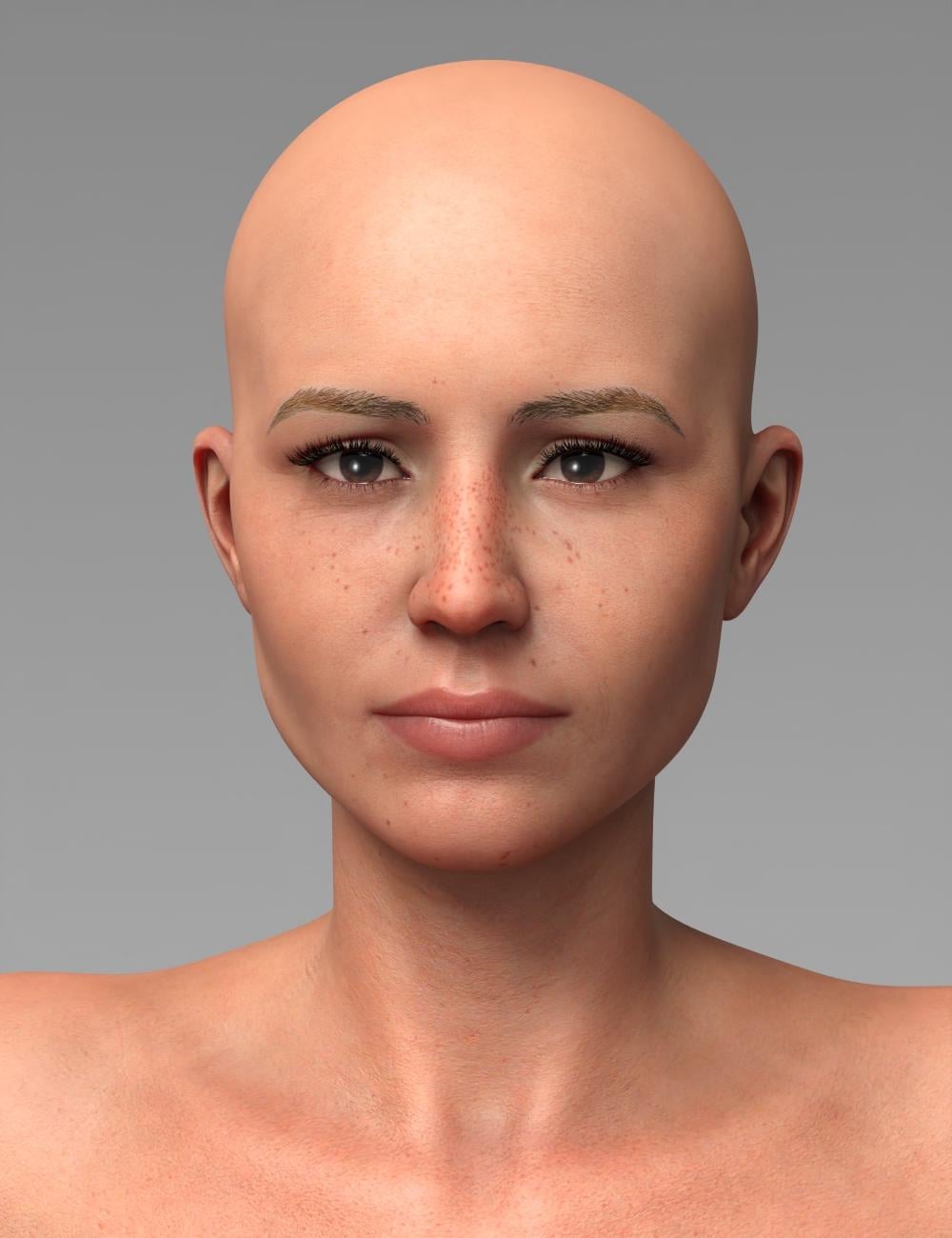

    Here is "SKF frreckles 02 A" on Jenni 8 at default opacity. It looks more like acne, pimples or a rash than freckles on her skin tone. I think perhaps at lower opacity or with a color change, it might look better. There are 4 opacity presets in the product.

    These are the steps I took to create the image attached above:
    1. Load Jenni 8 and select here in the Scene pane.
    2. Load SKF Shell Layer 01. This loads a geoshell named Facial Freckles Shell 01. The torso of the shell is white with 50% opacity.
    3. Select Facial Freckles Shell 01 in the Scene pane.
    4. Apply materials SKF Convert Geoshell Layer to Genesis 8 F. This turns off the opacity of the white torso of the shell.
    5. Apply material SKF Freckles 02 A.
  • barbultbarbult Posts: 26,661
    I updated my help request to gripe about the bad Smart Content metadata that lumps everything into Materials/Skin. The files that load the geoshells are of type "Accessory" and are not materials. Separating those with a proper metadata category would help, I think.
    edited July 2021
    Here is the same setup with the freckles opacity reduced to 45%. It looks much better to me.
    1000 x 1300 - 554K
