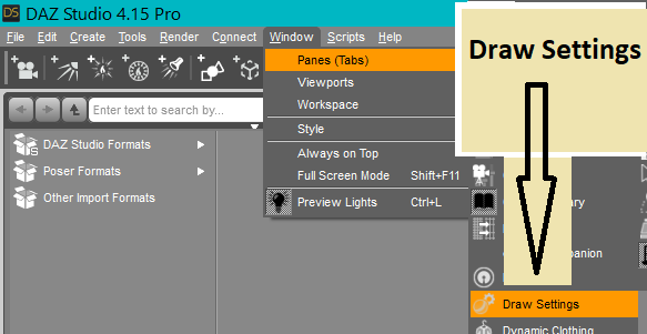

    Oddly enaugh my studio does not have a draw settings tab (or i cant seem to find it)

    For the Draw Tab, Check under Windows, Panes ...
    The fancy pbr skin shader requires 4.15+
    583 x 301 - 32K
