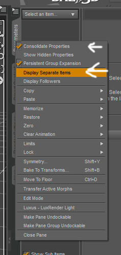

  • Richard HaseltineRichard Haseltine Posts: 111,972
    The options should be in the pane menu, as here - the settings I have will match the way DS3 worked.
    283 x 597 - 90K
  • LeatherGryphonLeatherGryphon Posts: 12,543
    edited January 2015
    Found it! Though I swear it wasn't there before. So many menus, so little time, ... Ghaaaaaaaaaa :-(
