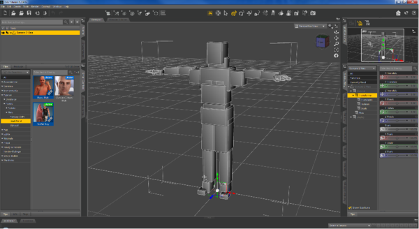

Next, I ran DS 4.7, as installed by DIM, and the very first few SIMPLE things I tried completely failed.
First, I double-clicked on Figures/People/Male/Real World/Genesis 2 Base Male and immediately got the "Missing Files" dialog for "/data/DAZ 3D/Genesis 2/Male/Genesis2Male.dsf" (see attached). I navigate to that location and, to no one's surprise, the DSON file is there (1.836 MB). DS just can't see it. Again: W.T.F.?? Excuse me, but the effing INSTALLER just finished installing all the ncessary content - how can there be any "missing files"??????
I click OK to clear that dialog and am greeted by a Perspective View containing the Minecraft 1.0 version of Genesis Male (see attached). Swell.

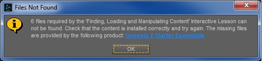

So... maybe I'm just doin' it wrong. I figure I'll run the Interactive Lesson on "Finding, Loading and Manipulating Content".
And... I'm screwed by DS again with another "Files Not Found" dialog, complaining that 6 files are missing (see attached), which should have been provided by the Genesis 2 Starter Essentials (which DIM has already installed). Again... W.T.F. ???

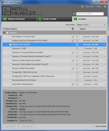

Okay, let's try installing something I purchased two years ago - Digital Curlz Hairstyle. I shut down DS 4.7 and then go select the product from my Product Library (on line), and click the "download & install" link under "Install Manager Ready". Seems to work. DIM shows the product under "Installed" and the product detail info looks correct (see attached).
Back to DAZ 4.7.
Click on the Hair category from the "Smart *cough* Content" tab and again, to no one's surprise, this newly installed product is absolutely nowhere to be found. I check every category on the Smart Content tab. No dice. The newly DIM-installed product is not there, anywhere.

    DIM is dimwitted in that it just does what you let it do, it does not communicate with Studio in any direct way. Smart Content is not smart, it is just a database system that uses tagged metadata, if you move your content the database has to reset and repopulated. The Content Library tab will always show properly mapped (setting the paths in Studio's Content Directory Manager) content.
    Edit: The old installers never talked to DS either. You can set up as many content install locations as you want in DIM. Make sure to check the Show Details box on the Ready to Install tab to be able to switch libraries locations before installing. User preference files are generated when DS and DIM are used and these files will not be uninstalled since the way DAZ updates DS and DIM is to uninstall the old before installing the new.
