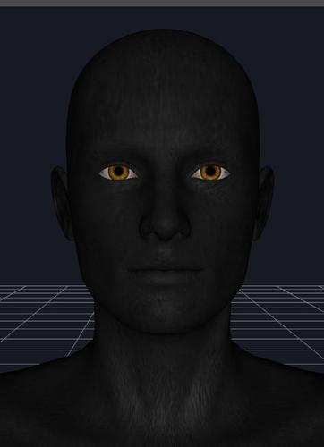

    However I have a newer problem. In the preview window of DAZ when I add a skin to my figure a dark spot shows up where I removed the nose. Is there is a way to fix this?
    Thanks

  • Richard HaseltineRichard Haseltine Posts: 111,325
    It looks as if there may be some shading on the base map, so even with the geometry flattened you still see a ghost nose.
    If you do divide your mesh in ZBrush, then put it back to base resolution for export, make sure you have the SMT button off - otherwise you will get smoothing even on the base resolution figure, which will thin the fingers and mess up the teeth among other unwelcome effects.

  • jestmartjestmart Posts: 4,449
    That look like you are using an anthropomorphic animal texture that probably does have a dark leathery nose painted on.
    Ah, at a glance I thought it was a human skin which was why I went back on saying it might be painted on the maps.

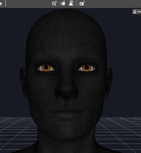

    Actually, when I add the Anubis texture to G2 Male figure in DAZ without any changes the dark shadow on the nose is still there? Pic below... kind of odd? The texture to the base mesh in ZBrush looks fine.
    Perhaps its just this skin that is applied and not so much when I remove the nose? Hmmmmm? lol
    That is on the texture, the only way to get rid of it would be to paint it out on a copy of the map or to use a different texture.

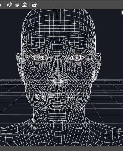

    I believe I figured out a way to get rid of the dark shadow! I found where the texture map was located and opened it in Photoshop. I replaced the diffuse color map with my edited version and it appears to have worked!
    Below, no more dark shadow around the nose and lip area! Yay!!! Thanks for your help guys!
