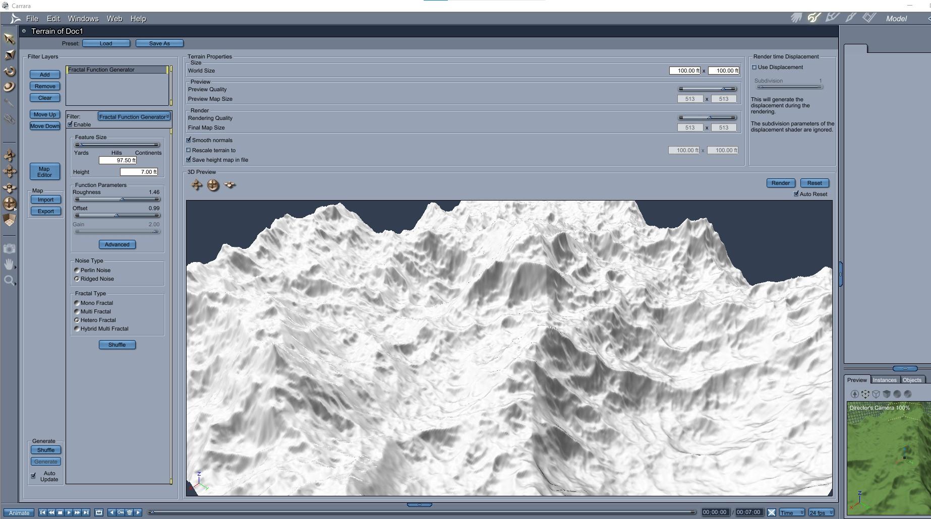

    - under filters, delete the default mountain generator.
    - Click add to get a new null.  Choose advanced generator, fractals.  Choose ridged noise and hetero.  Your result is likely too rough at the default height of 20.
    - Reduce the height and adjust roughness to taste.  Here I have set the height to 7.  The ridged noise gives a decent impression of a wave, in my opinion.  But you can play with the fractals to taste.

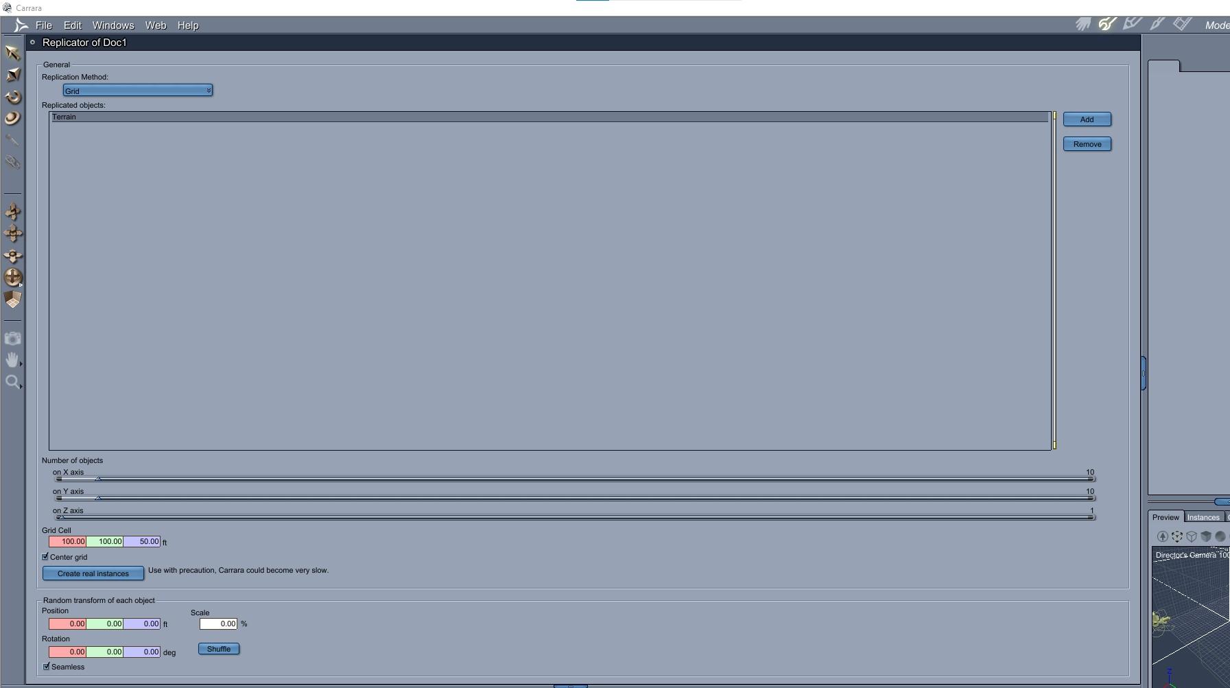

    - Insert a replicator (not the surface replicator).
    - In the replicator modeler, choose the grid option at the top, set the terrain for the replicated object, match the cell sizes to the terrain size (remember 100 default?), and check the box for seamless.
    - Now when you return to the assemble room the bounding boxes of the replicated terrain grid should match up

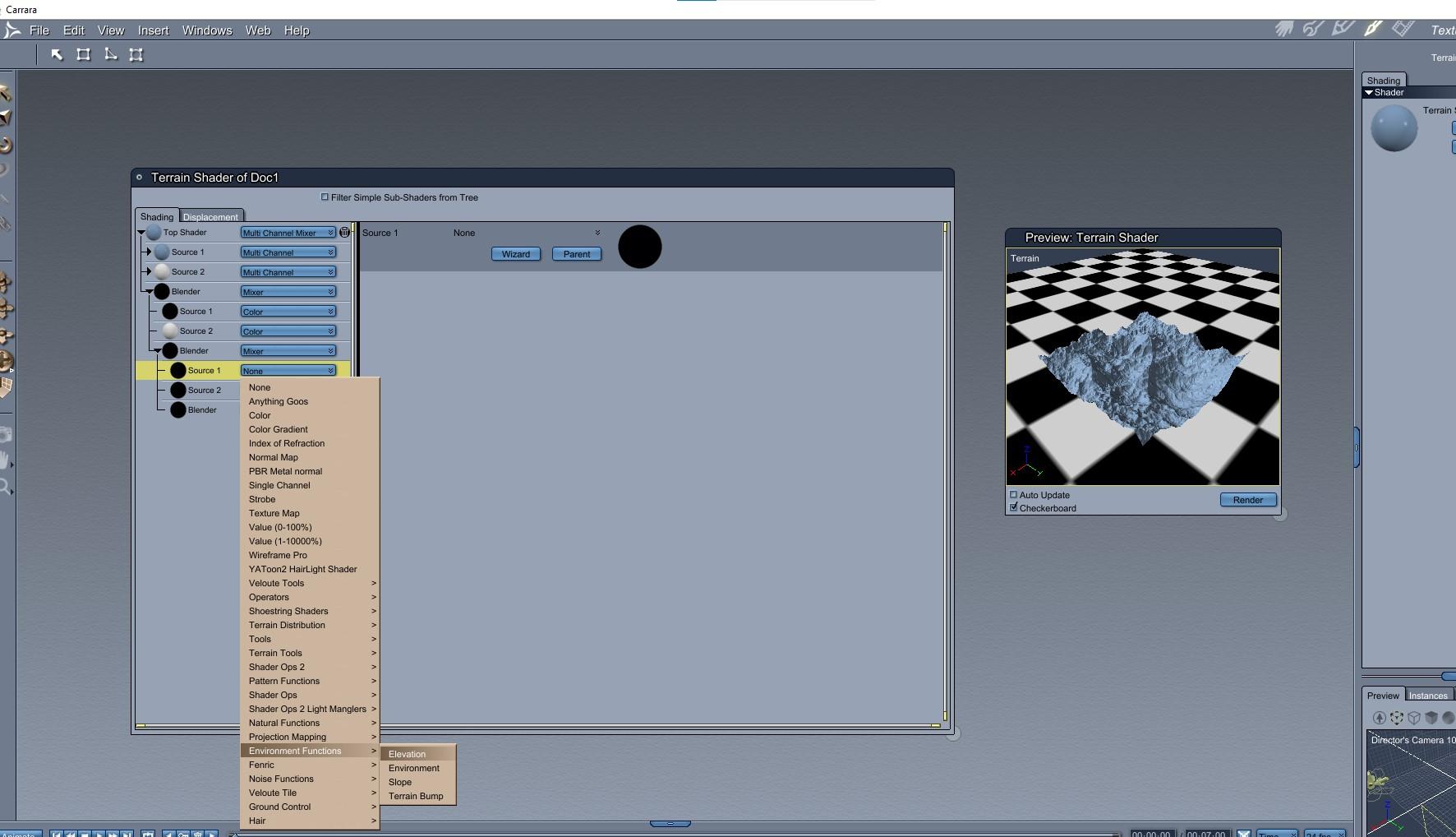

    - For the shader, I would start with a multichannel mixer to isolate the water and the foam.  Other approaches could be good like a layer''s list.
    - Here is an example of a multichannel mixer with simple blue and white shaders.  For the blender, I recommend using the environment channel options for height and slope.  You will have to adjust the height quite a bit because the terrain is so low.
    1737 x 923 - 157K
    1752 x 1000 - 370K
    1846 x 1030 - 354K
    1845 x 1006 - 158K
    aa05 regular replicator set to grid then terrain as reolicated object match grid cell size to terrain size default 100 check box seamless.jpg
    1793 x 1003 - 150K

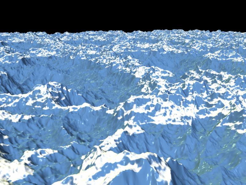

    1465 x 723 - 204K
    1772 x 1018 - 254K
    800 x 600 - 89K
