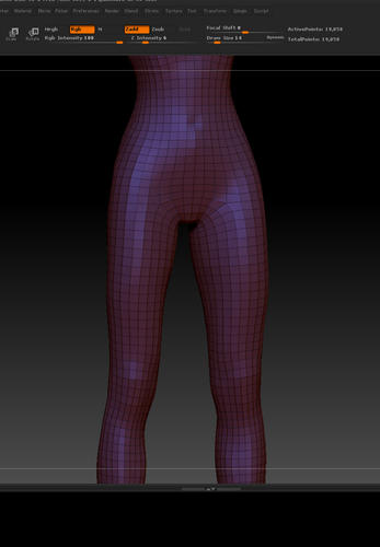

    If you click on the topology brush prior to remeshing you can set up guides as to how you want it. That helps...
    edit to add image...This was a morph I was playing with for Dawn, just quickly remeshed using the topology brush. I used two guides one vertically down the centre and one horizontally at the waist.

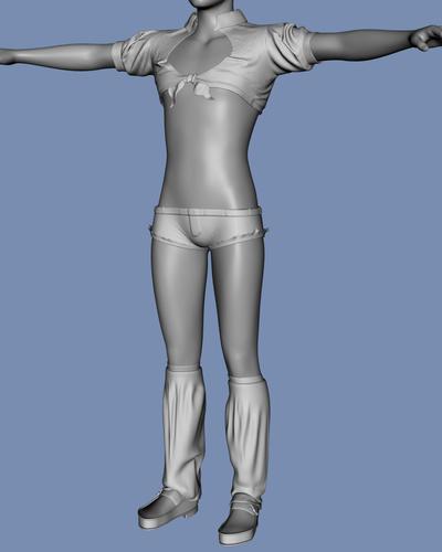

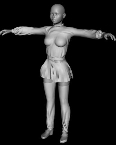

    These are some of the outfits I've made recently with 3D Coat.
    1000 x 1250 - 176K
    1000 x 1250 - 137K
    1000 x 911 - 126K
