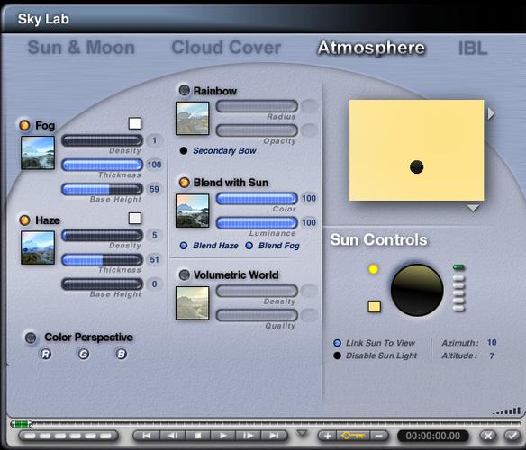

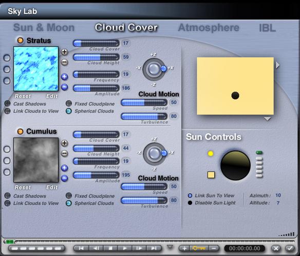

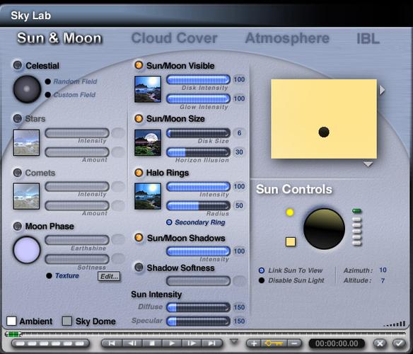

    Some random notes I had written down about haze that may or may not help when working with it:
    To make the white line on horizon blend better with the sky: Set cloud height for cumulus at max, even if you don’t use the clouds. Switch cumulus on, set cloud height to max and switch them off. This distributes the haze more upwards instead of just a bright line at the horizon.
    The haze color can also be set to more closely match the sky and make it less obvious.
    My sky lab settings
    626 x 536 - 138K
    626 x 536 - 138K
    626 x 536 - 154K
