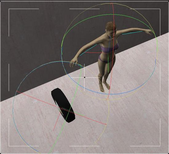

For example, lets say you load a simple automobile tire and a V4 into your scene, and they look like the attached image. This can, and probably has happened to you, for a number of reasons.
Bummer, right? Because if you rotate the V4 abdomen bone, for example, or rotate the tire like it's rolling down the road, what do you get? It's all cattywumpus. The tire wobbles, and V4 tilts sideways.
So how do you fix it? Well, you adjust the hotpoint orientation for the tire and the V4 abdomen. And the way you do this is to simply enter a value in the X, Y, or Z orientation fields, depending on which you want to modify. This re-orients the rotation axes of the manipulator. In this case, since the V4 abdomen orientation is off by about -30 degrees, you rotate the manipulator by about +30 degrees on the Z axis, and it will now be aligned with the correct axis so you can make her bend correctly at the waist. And the tire manipulator orientation is off by about +40 degrees, so you adjust the Z axis value by -40 degrees and the tire will roll down the road correctly.
Yeah, it might take a little trial and error to figure out how much to adjust the orientation to make it exactly where you want it, but it's fairly quick and painless.
