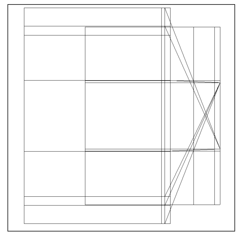

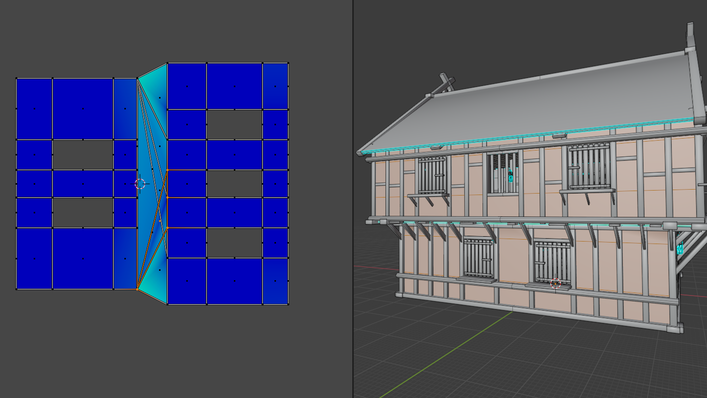

    I do have another issue that I can't quite figure out. A lot of DAZ products, including many by Faveral and others that use seamless tiling UVs, do not seem to be coming over properly into Substance Painter. I assumed this was because my own export settings from Studio might be wrong, but I've tried many combinations and only one even partially works.
    One image here shows the Timber Houses 1, house 1 product in DAZ Studio with the lantern's candle texture map applied to the wood panels. You can see that the tiling isn't distorted. In the next image, previewed in Substance Painter and with a procedural wood texture applied, there are bands along the lower sections of each floor that have completely different tiling than the rest of the surface. Can anyone explain why this is happening? Is it the mesh or are my settings (also posted) wrong?
    In my settings, this is the only combination so far that Substance Painter would even open (otherwise I get the "Failed to Load" message). For any other type of object, these are the settings that I use *EXCEPT* Collapse UV Tiles is unchecked, and it works.
    Thanks in advance for any suggestions.

    Wendy: It sounds like you had the same problem I'm having, but there doesn't appear to be a fix for this (not yet anyway). Substance has the usual UV transformation sliders (scale, rotation, offset, and type of UV wrap like tiling, repeat horizontally, etc), but nothing fixes this problem.
    Margrave: Yeah it does and I tried it many times along with every other setting Substance has. There's something about the UVs themselves that appear to be getting tweaked upon import into Substance Painter. I even tried letting it unwrap the model itself (a new feature), that resulted in UVs where almost everything got painted on with any brush stroke.
    I guess I'm going to have to try sending various products with tiling UVs over to Painter and see if any come over properly. If some do, it's got to be something with the original DAZ product's UVs.

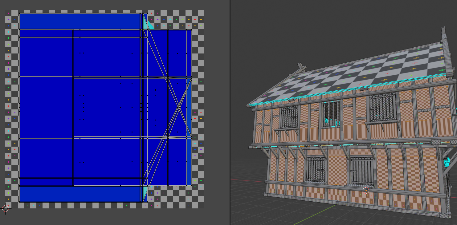

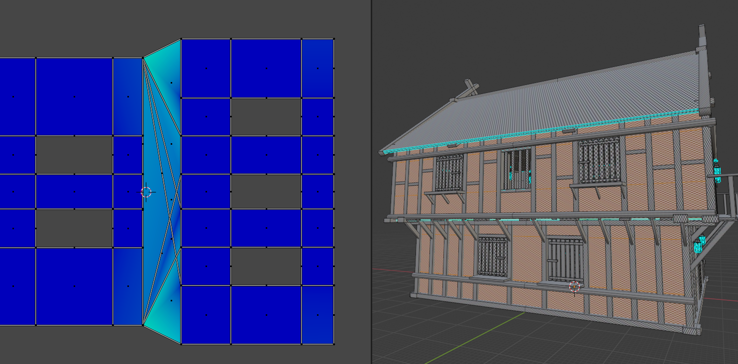

    UV Map In Daz
    Collapsed UV in Blender
    Collapsed UV in Blender with UV Grid
    Uncollapsed UV in Blender
    Uncollapsed UV in Blender with UV Grid
    As you can see, Daz's UV viewport shows the texture is collapsed by default. When imported into Blender with the UVs collapsed and assigned a UV Grid, we see the warped stretching. The uncollapsed UVs, on the other hand, are five times bigger than the UV space and stretched horizontally, but are otherwise fine.

    821 x 804 - 11K
    1427 x 804 - 356K
    1483 x 732 - 651K
    1427 x 804 - 345K
    1483 x 732 - 835K
    Post edited by margrave on

    UDIM is a UV mapping technique where multiple texture maps are laid out next to each other in one image file, since it's faster to render than multiple separate texture maps. Normally, UV coordinates wrap around if they go outside the 0.0 - 1.0 range, but UDIM requires they be allowed to go past that range so they can look up adjacent textures tiles.
    Collapsing the UV Tiles will fold them so they all fit within the 0.0 - 1.0 range. That's why the collapsed tiles fit in Blender's UV editor and the uncollapsed ones are five times bigger.

  • Richard HaseltineRichard Haseltine Posts: 111,688
    Looks as if Painter doesn't like polygons that span UDIM tiles. Unfortunately that is a technique (perfectly legitimate) that has been used for a long time to get texture tiling when the application s did not support it directly - application have always wrapped UVs, so anything in the [1,2] range is treated as being in the same postion in the base [0,1] range. UDIMs exploit that behaviour to move entire UV islands to a new tile, so they are separate but still behave as expected. This is a Painter limitation or issue, rather than an issue with the mdoels per se

    Hi SnowSultan.
    When exporting from DS, do not collapse UVs, it is bugged, well, it is certainly corrupting the UVs on that model.
    So, in DS, export without collapsing UVs. In SP, import with option "Use UV tile workflow" disabled (not checked/ticked)
