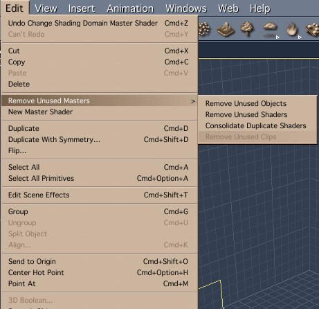

    Another thing that can help is a little scene housekeeping. Sometimes in the course of building a scene, you may try different objects or shaders and decide you don't want them, and delete the object or replace the shader. They're still there, contained in the scene file. Tp purge the unused items, go to Edit--> Remove Unused Masters. Under that is the option to remove unused objects and shaders, and to consolidate duplicate shaders.

    Thanks for the tips, turning of compression made a huge difference, it's down from 4-5 minutes to 30 seconds now.
