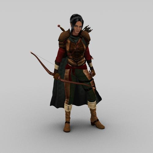

    I have a question about this... as I'm trying to convert a V3 outfit (Dragonworld: Wildenlander). Everything does very well and the SRMS system does a much better job than the standard options. I've even found that doing the top and pants with the body suit gives a better fit. Heck, I was able to get the cloak to work pretty well using the dress option.
    My problem is with the shoes. The shoes have a slight heel, so the foot needs to actually slightly elevated with the toes on the ground for the shoe to match, but no matter which option I choose (BootsThigh, SRMBootBase, SRMBootForGen4, SRMBootForGen4NoToes), the foot never adjusts and the boot stays in the original position. Usually I have the most success with the SRMBootBase, but no luck here at all.
    Any suggestions?

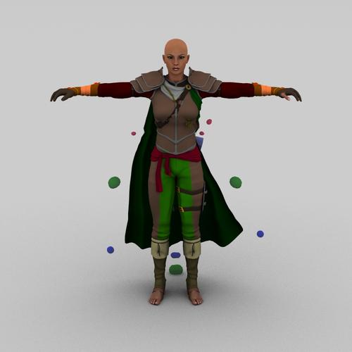

    Well, I found out the problem and it had nothing to do with AutoFit or SRMS.
    The Wildenlander for V3 set required that you hid the foot once you added the boot. If I remember correctly, this was something that we did pretty regularly in Poser to make clothing look good without poke through. Once I hid both feet and toes, she turned out pretty good.
    I did run into an issue with the dagger sheath not parenting properly as well as the dagger and sword. They should have been in their respective sheaths, but no luck. Once I posed the character, the sheath did not stay with the thigh, but it's currently parented to the thigh of the pants. I'll move it to the thigh of Genesis and see if the same problem exists.
    Here's how she turned out after I lightened the texture's specular color to keep it from being too dark.
    I just want to say thanks for the SRMS system. It's allowed me to keep using items I bought almost a decade ago and made my wardrobe so much more versatile and useful. It's been worth every penny.
