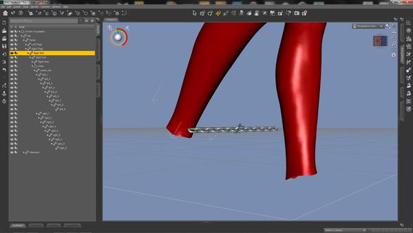

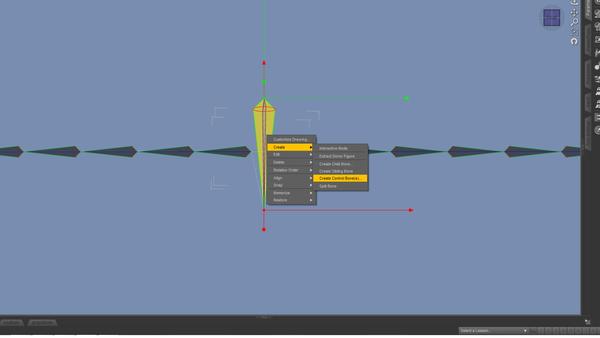

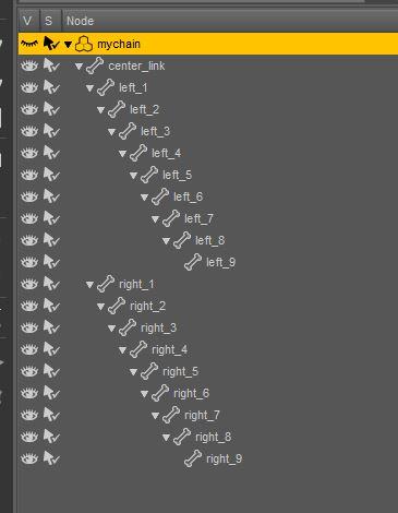

I am trying to make a set of restraints (hand cuffs) be controlled by the hands they are parented to. I have re-rigged them. I have split them. The problem is this if I use normal IK then the cuff part is at the end of the ik chain it moves all the other links fine. When I parent the cuffs to a hand then the cuffs root moves not the cuff for the hand. What is the Create Control Bone? Is there a way to have reverse IK?

    Hmm. I've been experimenting with this, and I'm confused, too. I can't find that a control bone does anything differently from any other parent bone. Maybe it's just intended to be a shortcut to adding a parent to a bunch of bones at once?

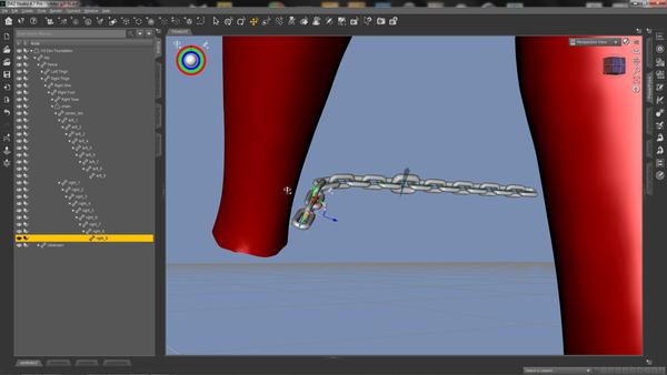

    Chain with IK Parented to main figure. But what I'm trying to do is have the foot control just end of the chain where all the IK movement is controlled for the chain. Then pin the root bone of the chain so when main figures foot moves it causes the chain to bend twist etc. If I just parent the chain to Main character it just moves the entire chain model but with no IK. ie chain stays in straight line unchanged. (see top pic below) I'm am trying for something more like in pic 2 where the outer most bone is controlled by the foot that way I get the movement down the chain IK.

    DS IK doesn't support parentable IK targets, so you can't really do what you want I think. You can use the Property Hierarchy to link one control on one figure to another on another figure, but you have to save them both together in order for that to reload (or make a script to rebuild the link).
    edited December 2014
    What he said. I wish we could, or I'd have done it a lot by now with my own rope and chain products. ;) You could try a kludge where you weight mapped it to each shin and blended between them in the middle, but it will cause really ugly and unrealistic stretching in your chain. I've always had to just set it up as a prop that goes with a pose and load them together.
