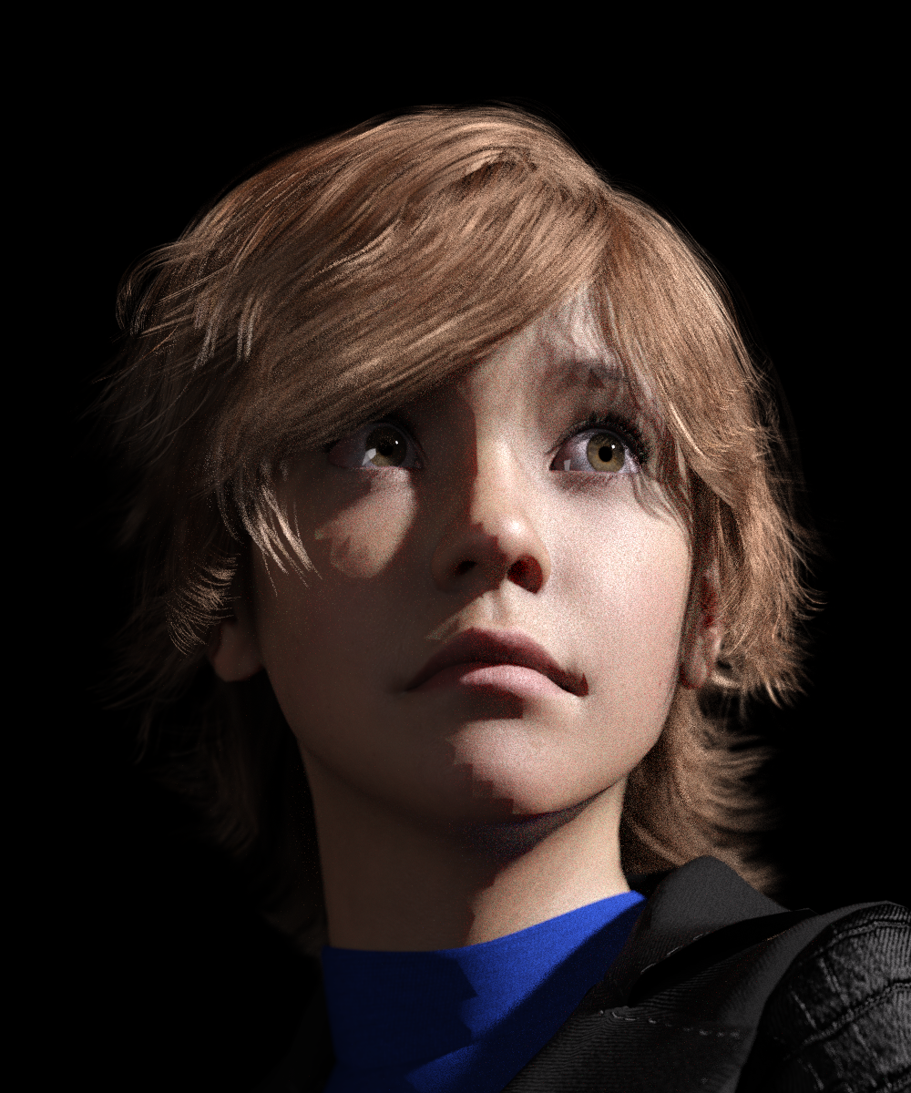

Did some experiments with the amount of light needed to render in spectral mode (Natural at cie1964), and I thought I'd share my findings. I set bluejaunte's Amira at base resolution to render quicker, so ignore the ugly quads on her face. All the images have one dim, wide fill light to the left and a key light to the right. Only the key light and the spectral rendering toggle was changed. The images were set to render for 1,000 samples apiece.
Tonemapper
  • Shutter Speed: 45.0
  • F-Stop: 16.0
  • Film ISO: 800
Fill Light
  • Spread Angle: 90.0
  • Beam Exponent: 1.0
  • Light Geometry: Rectangle
  • Height: 108.0
  • Width: 48.0
  • Luminous Flux: 7,500
Key Light 01
  • Spread Angle: 60.0
  • Beam Exponent: 4.0
  • Height: 108.0
  • Width: 48.0
  • Luminous Flux: 15,000
No spectral rendering, default light angle. Her skin has a noticable pink/orange tone to it, too much saturation for a film noir-ish image. The shadows are too soft as well.
Key Light 02
  • Spread Angle: 15.0
  • Beam Exponent: 32.0
  • Height: 108.0
  • Width: 48.0
No spectral rendering, narrowed the spread angle and upped the beam exponent to sharpen the shadows. Despite the better shadows, the image is much, much noisier due to the concentration of light rays.
This is a variation with the lumens turned down to 5,000 to try and offset the noise. It didn't work. It's still just as noisy, but now it's dark and noisy.
Key Light 03
  • Height: 108.0
  • Width: 48.0
  • Luminous Flux: 150,000
Spectral rendering enabled, same settings as Key Light 01 except the lumens have been increased tenfold to account for the increased light range. Her skin is paler and less saturated, but since that's exactly what I want I'm fine with it.
Key Light 04
  • Height: 108.0
  • Width: 48.0
  • Luminous Flux: 1,500,000
Spectral rendering on, same settings as key light 02 but the lumens increased one hundredfold. A tight angle and a high exponent are where spectral rendering really shines-- pun intended. Her skin has the nice desaturated look from 03 and the hard shadows from 02, but the ugly noise that made 02 unusable is almost gone. It's still there if you squint, but this was only rendered to 1,000 samples.
Conclusions
Spread Angle and Beam Exponent, two important controls for shaping light in Iray, are pretty much unusable without spectral rendering due to the noise they introduce. Broading the color space with spectral mode allows you to get better desaturated skin tones and nice sharp shadows, but you need to boost your key light by at least 100x. Probably a little more, since 04 still isn't as bright as 02. Spectral mode doesn't seem to affect wide angled lights with low exponents--despite staying at 7,500 lumens the whole time, the fill light (90 deg., 1 exp.) barely changed, whereas toggling spectral rendering turned a concentrated spotlight (15 deg, 32 exp.) from overblown to pitch black. There's also a bug in spectral rendering that makes UV seams visible on some models, which further cripples this very useful tool, but since this image doesn't have any seams visible it didn't matter here.
If anybody has any insight into the exact lumens adjustment ratio between normal and spectral mode, I'd be interested to hear it.
