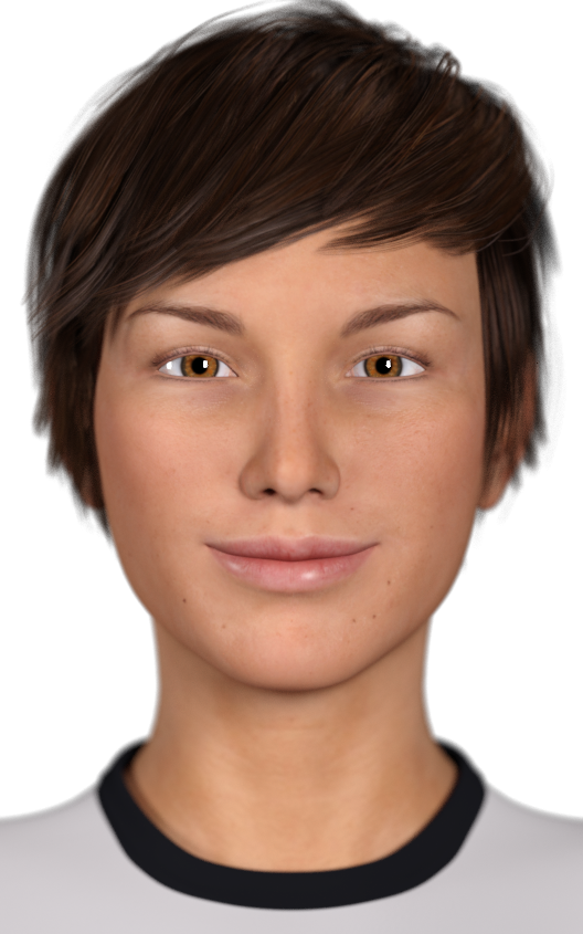

SMILE

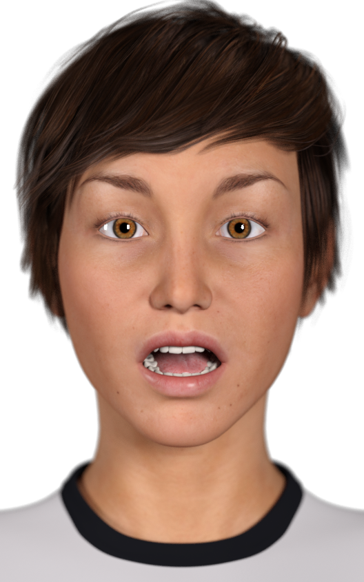

FEAR

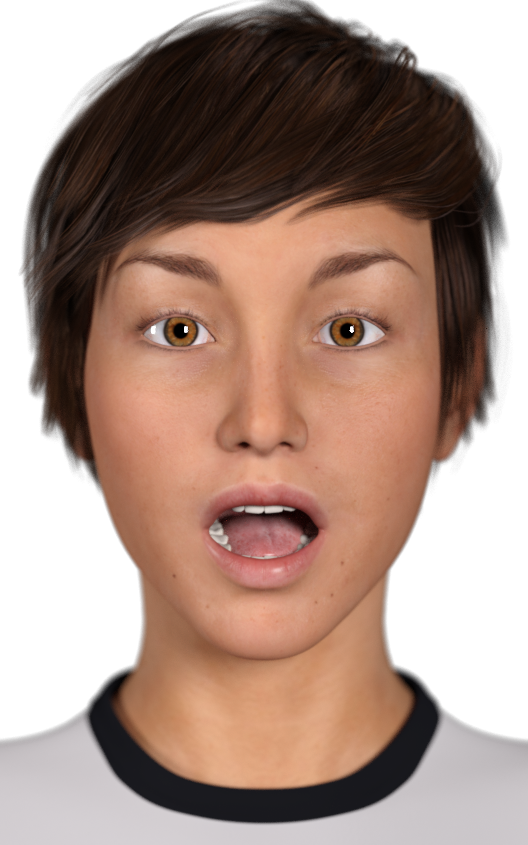

SURPRISE

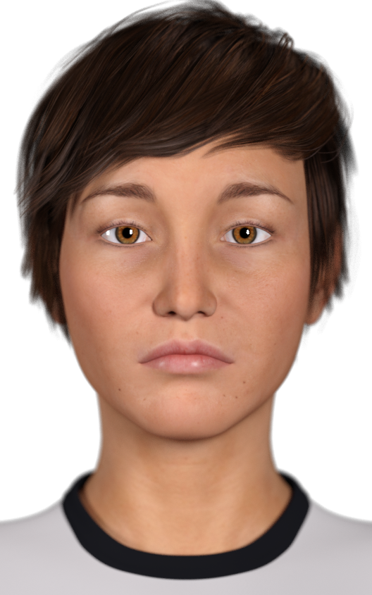

SADNESS
Surprisingly, you can get some good, realistic expressions out of Genesis 3. I probably wouldn't use any of these out of the box--the eyebrow raiser in particular isn't great--but it's definitely a nice base for modification. While I still don't think Genesis 3 was designed for expressivity, with a little work I think this tool can surpass all those vacant stares in the Daz shop.
