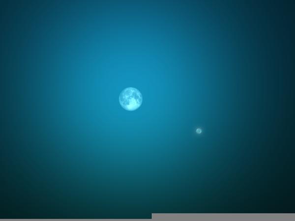

  • eponicaeponica Posts: 197
    Yes, I've been playing with that idea too :)
    I love the Carrara space objects, I just turned Pluto into an extra moon :) The aura controls are so nice, and the glow shader works great!

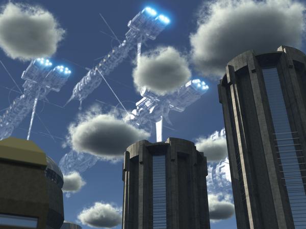

    I have nifty solution that works with the realistic sky. First, turn off the moon in the editor.
    Here's what you do:
    Set up your scene and lights.
    Save a copy of your scene.
    Open the copy and delete the terrestrial objects, but keep the lights and cameras exactly the same. Put in your moon or planet object. You could do that in the first scene and just delete everything except the planet, lights and cameras if it helps with framing.
    Make sure that the atmosphere is removed as well. Render the scene. The planet or moon will appear against a black background. Save the render.
    Now, open the original scene, if you put in your moon or planet, then hide or delete it.
    Keep the atmosphere and select Map in the Backdrop pulldown menu. Load the picture you rendered.
    Now, when you render your scene, the planet will appear behind the atmosphere. This looks really effective if you use clouds.
    You could do it with other things as well. Need a giant space station in orbit? An attacking alien fleet? Works great!
    2000 x 1500 - 897K
    That little effect also works if you stick an image in the Background. The major caveat being that since the Background wraps around the scene it should be a spherical render, and a large one at that. The plus is that it reflects in objects that have reflection and if you use the Skylight option in the render room it will contribute to atmospheric light in addition to what the realistic sky contributes.
    The image in the Backdrop does not reflect or act as an image based light. It only fills the production frame, so any image you use should be the same aspect ratio as the final render.
    You can also load animations into the Background and Backdrop, although the Background would be rather impractical.

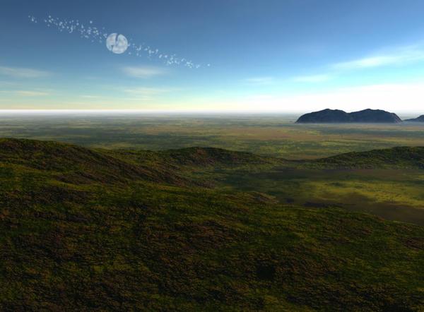

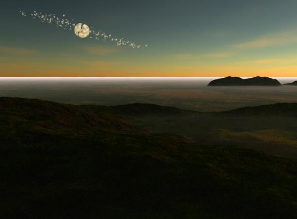

    This solves a problem I'd been fiddling with for the last week - I had a "broken" moon I wanted to put in the sky and I couldn't figure it out. Here's a couple test renders I just did using your technique. In the second one I turned down the brightness on the backdrop to make it look a little more faded as the sun rose. I'll have to play with this some more, but I think it will work perfectly for what I want to do.
    Thank you!
    Mark

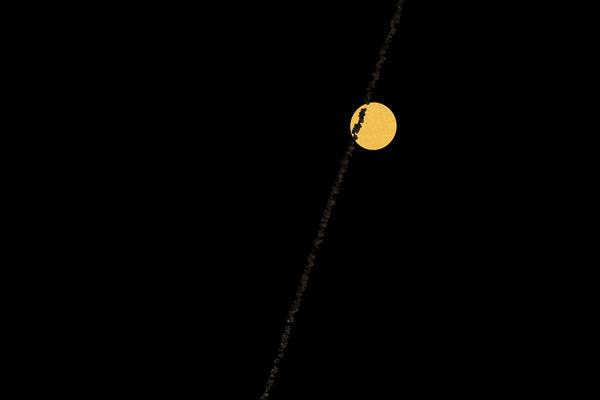

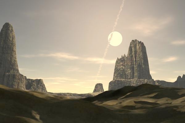

    I used Holly Wetcircuit's photoreal sun tutorial from the Carrara Cafe and decided to try an alien landscape. I also made a torus and replicated asteroids on it, but I think I need to use even more artistic license and make it more prominent. This was just a quickie and I already have an idea for a more detailed take on this scene.
    As I mentioned, I had followed Holly's excellent tutorial and made the sun. She also uses a bulb light with a lens flare to sell the brightness of the sun. I didn't want the flare in the scene I rendered for the background image, so I set the flare to none for that copy of the scene. I did want the flare for the main scene, so I got rid of the sun model and kept the bulb light with the flare and used that for the light in the scene.
    Before I got rid of the sun model, I used it as a guide to line up the RSE sun disk and aura with the model. Once that was done, I retained the bulb light and lens flare and deleted the model. I went into the RSE and kept the aura, but turned the sun disk's size down to 0%.
    When I loaded in the render for the backdrop, the aura and lens flare in the scene line up perfectly with the backdrop.
    I should also note, that in the scene with the ring and sun only, I added a distant light pointing back at the asteroid ring for reflected light. I excluded the sun model from the distant light.
