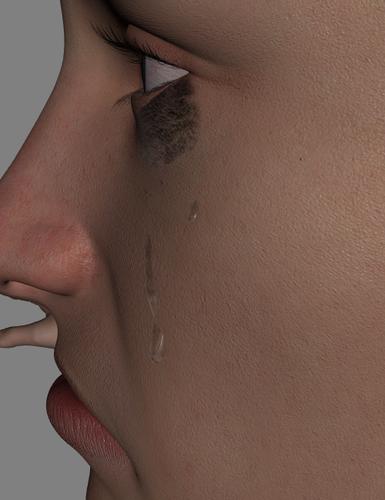

    Ok, so select the figure and go to Edit>Object>Geometry>apply smoothing modifier.
    Then select the tears in the scene tab and go to Parameters>General>Mesh Smoothing and raise the smoothing iterations.
    In the image, I have the expression, Sad, cranked to 1.0. Without smoothing, it digs into the cheek. Smoothing set to 76 iterations seemed to do the trick.

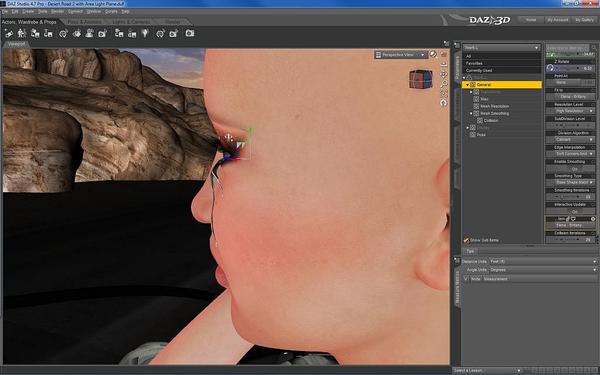

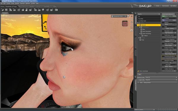

    I took a couple screenshots (sorry about the lousy quality) to show what I'm referring to. I'm glad you saw the poking through into the cheek thing. I did some testing and the only way I could get the tears to come out of the face was to change the smoothing and collision. however, as seen in the second pic, it's flowing over the eyelash.
    I tried the suggestions you made, but it didn't seem to do anything. I have a couple expressions in play, Confused to 1.0 and Fear to .045. I also have Inner Brow Up set to 1.0.
    I put together a base test figure (Aiko6/EstrellaFull) and applied tears to both eyes and it worked immediately just fine. I checked to make sure this was a G2F and it is, V6/BritanyHD. I'm still puzzled by this. Setting the Collision Item to her left eye didn't seem to do anything either. Maybe I'll have to use another character. I don't want to have to drop the expression as it's important to the scene.
    1024 x 640 - 79K
    1024 x 640 - 80K
  • Cris PalominoCris Palomino Posts: 12,964
    edited December 2014
    You only have 2 iterations in the first/26 in the second, but also collision, if i see that correctly, go higher till you see it not sinking into the skin anymore. Mine was in the 70s for smoothing, I didn't use any for collision.

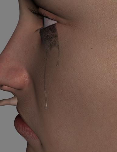

    Edit 2: Ok, I did a bunch of fiddling and I got some pretty good results, not perfect, but good enough. It seems that the tears couldn't handle the lifting of the cheekbone very well (the Confusion setting) straight out of the box, so I had to do some coaxing. Final settings: Smoothing: 11, Collision Item: Britany, Collision: 2. See attached pic for results (quick aux viewport render which include some surface adjustments).
