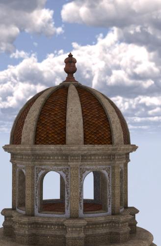

    I think you must not have them set up properly, as SoE work fine for me. Any properly mapped IBL (e.g. spherical/LatLong format) will work in R4 as well as it would in R2.5 because nothing has changed in the way IBLs render. I've attached a quick (3 min) render using of the SoE IBLs which looks fine to me. It matches the DS viewport preview perfectly.
    What has changed, though, is the way in which they are setup. Reality 4 uses sIBL .ibl files to set up IBLs and the old scripts that were used to load IBLs in 2.5 no longer work, in that they will not be picked up by R4. This applies to all the IBLs provided with R2.5 and third party sets such as Dimension Theory's "Skies" series. The problem with the latter is that they don't come with sIBL .ibl files. You can, however, make your own.
    I've created a simplified sIBL file template which can be used to load Skies of Reality/Economy or any other spherical IBL. There are two ways you can use the .ibl file: one is to launch R4 and navigate to it from the IBL section of the Lighting tab (which is what I do), the other is to create a .dsa file using a modified copy of one of the script files that come with R4 as a template. The second way enables you to load your IBL from Studio, but requires more steps to create. When loading the IBL in Reality, do not have an old (R2.5) IBL preview sphere loaded in DS viewport as it will not sync—R4 will load one into Studio for you and sync it.
    Below is the sIBL template and comments, which I've copied from a post I made elsewhere (slightly edited).
    Paste this into a text editor and save with a suitable title and a .ibl extension. The file needs to go in the same folder as the referenced images.
    [Header]
    Name = "Skies of Economy Sunny 4"
    Author = "Dimension Theory"
    [Background]
    ; The image that appears in the DS viewport
    BGfile = "SoE-Sunny4R.jpg"
    [Enviroment]
    ; Gamma picked up from here
    ; EVfile name required (image used by Luxrender)
    EVfile = "SoE-Sunny4.exr"
    EVgamma = 1.000000
    [Reflection]
    ; The image used by Luxrender
    REFfile = "SoE-Sunny4.exr"
    Note that I don't know what the gamma correction should be, but from tests a value of 1 (default, in any case) appears to be correct for the "Skies of" images.
    To use follow the instructions in the RUG: from the IBL section of Lights, activate IBL, click Change and navigate to the IBL folder and select the .ibl file (not the EXR, JPG, etc.). The preview sphere will be loaded into your DS scene, and from there Y rotation will be synced in Reality.
    There are many other parameters in a sIBL file, but I've excluded those which appear not to be read by Reality in order to keep the file simple and easy to edit, but if anyone knows of any excluded parameters used by Reality, please let me know.
    You will need to keep an eye on the gamma values in some sIBLs. For example, with the Chelsea Stairs IBL (this is a great quality IBL) from the sIBL archive, the .ibl sets gamma at 2.20. This is way too high for Luxrender. The whiter parts of the map glare like spotlights, while the rest of the map is too dark. I put it down to 1.00 which looks OK, although it could possibly be a little higher.
    525 x 800 - 82K
    Post edited by Hiro Protagonist on
