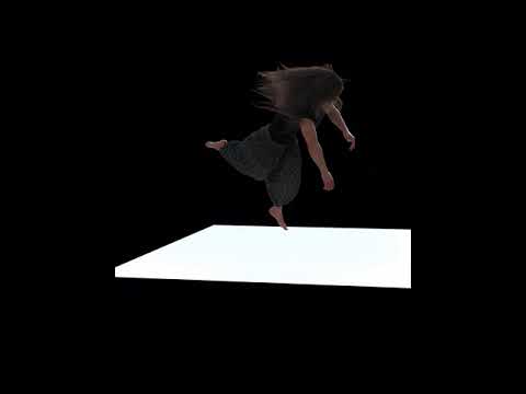

    I made this as an experiment.

    I don't know, dForce seems pretty usable for animation to me.
