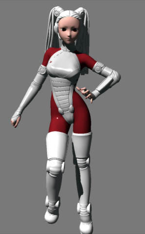

    Have you tried in a brand new scene?
    - Load Aiko, ZERO her
    - Load each piece by dragging it from the browser to the "blank space" in the scene tree - do not drop it directly on Aiko
    - Conform each piece with the general settings "fit to" drop-down.
    I get a teeny bit of poke-through, but nothing like what you describe
    298 x 480 - 28K
    Post edited by Fenric on
