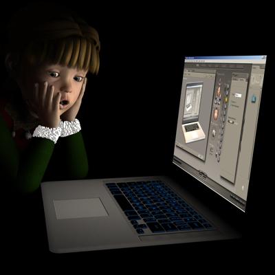

  • glaseyeglaseye Posts: 1,312
    here a sample with UberArea lighting, the laptopscreen and the keys are set as an UA light... no other lights used

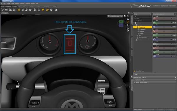

    Hmmm... the surface I want to create a light on is not a selectable area, at least not the small part I need the light on (the dash in a car). I'm trying to create a small part of the dash glow red, like a warning light (see attached pic). Since I can't select just that panel, I don't know if an uber light would work. Perhaps a spotlight of some kind, with very low intensity, set just in front of that part? Having the red reflect off the steering wheel would be a bonus.

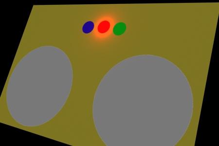

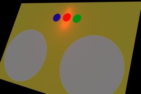

    I think I get the point of what you want
    Yes, a very low intensity pointlight can do the trick, but a pointlight will give a round light effect on the dash
    With an area light, you can use just about any shape; the UberAreaLightPlane good be a good start for that, rescaling the x and z scales
    some examples with the use of an arealightplane and a pointlight
    450 x 300 - 38K
    450 x 300 - 38K
    Post edited by glaseye on

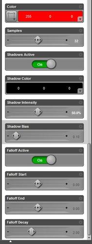

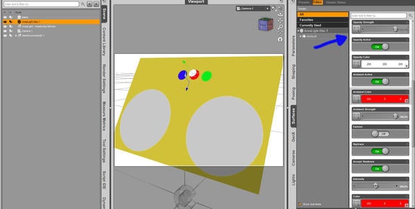

    How to setup an arealight? here some examples (used the arealightdisc here, as that suits this 'fancy' panel better :lol:
    The big picture shows the posiition of the area light, now for this example, the arealight's opacity is still set to the default 100%; for rendering that would have to be set to 0%.
    The 2nd image shows some additional settings for the arealight.
    The 3rd is the rendered result
    (There is also an UberEnvironment light used to produce the ambient light for the scene...)
    Now in this way, the area light would not illuminate the wheel, but for that effect you could create a second arealight at the same postion, but rotated 180degrees compared with the 1st arealight....
    What intensity works best is a matter of (loads of) trial and error ...........
    I hope this helps
