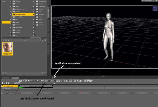

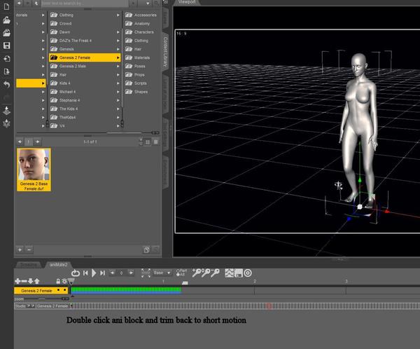

    You can double click the aniblock you have on the timeline , and trim back the ani block on each side until you have just the portion of the motion you want.keep, then right click the aniblock and save as a new ani block That will give just the part of the motion you want,
    you can also trim the aniblock back to the point where you need that particular motion to stop and then join the next ani block your going to use next and trim that one to match as close as you can to the next aniblock. , In the process if the character turns left or right then click the animate timeline you can adjust the speed of the aniblock motion and realign the joined ani blocks to match direction using the the Degree orientation tool next to the speed tool located on top of the timeline
    if you hand keyframe yor motion and want to save it to use again over and over .. then highlight your keyframes you created and right click and bake save as a Ainblock, if you are using BVH files than save as a direct HVH copy and turn it into a aniblock.
    there is a lot of trial and error playing around with it until you become use to using aniblocks & the animate timeline & once you get use to trimming and baking your motions files you will be creating custom aniblocks in no time
    , I rarely use keymate any more. and only use graph mate when I need to use more than one motion ani block for the same time line space.
    I hope that helps and good luck
