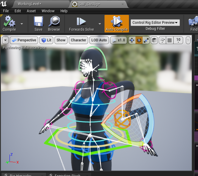

Has anyone been successful at setting up IK in the Control Rig? The way the bones in the Daz model are set up, as a chain from bend-rotate-bend-rotate, plays merry-hell with any attempts to use IK. I have even tried use IK on the controls at the joint rotation, but there is something fundamental I think I am just missing. I've managed to setup FK on the main joints, and I'll try to map a backwards solve so I can target joint motions through animations, but IK, at least for the legs and arms, seems unattainable.
FK setup:
IK Attempt (many, many failed attempts):
Any suggestions?

    Well I think I found a solution to it. UE5 will have a native version of this, but there is a BETA version of the Fullbody IK which more or less should allow for nearly full replication of many of the body controls. I can't beleive I didn't find this before now.
    I still have a lot of setup to do and more playing around, but for anyone looking for the solution, this can be found in plugins.
    Tirick.

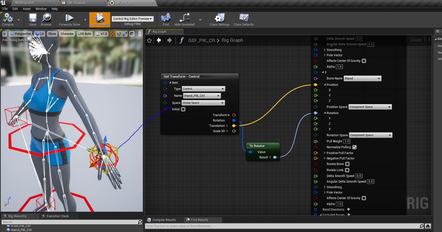

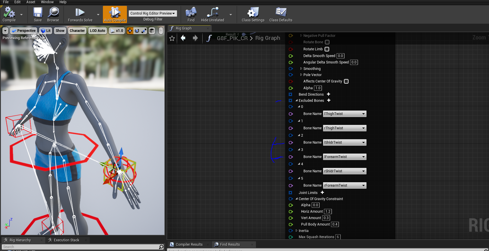

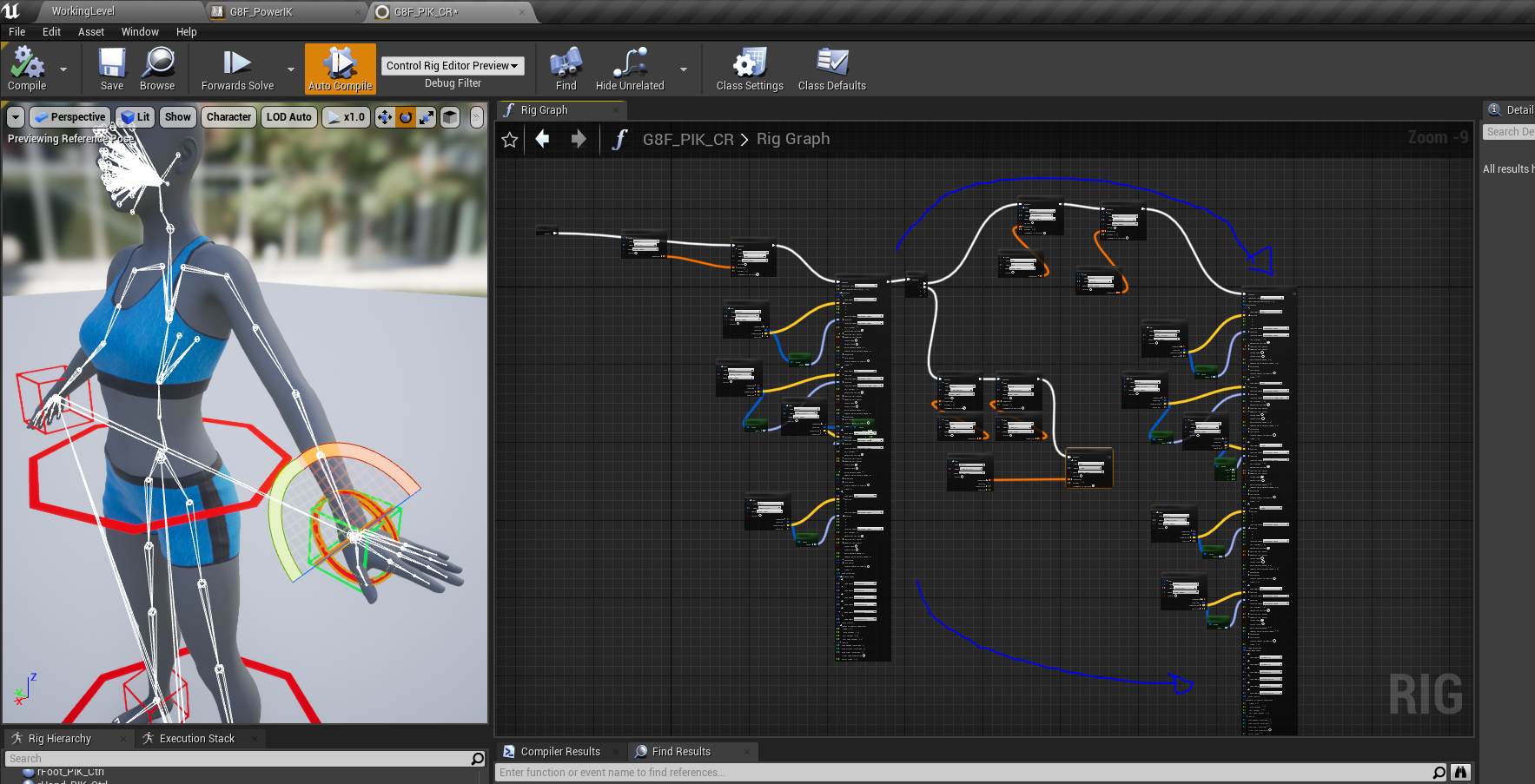

    So this is super rough as it is in the state I more or less burned out on, but here is roughly how it works.
    Left Hand Power IK control node moves the hand node and is the driver/target for the IK solve. You can pull it out of position but the hand (and the chain) will try to follow it regardless.
    You can specify which bones the IK solver will ignore in the solve. This permits the arm to follow the node and bend only on the bones you want (like the lShoulderBend and lForearmBend).
    I then cycle through and have a dummy control follow the hand bone. There is a Left Hand controller that is parented to the dummy that is used to control rotation of the hand itself.
    Lastly (and this was the epiphany, really) I rerun the IK solver using a similar hip dummy to the hand as a bridge. The Hip control is added in the second solver (I got to this thorugh watching the PowerIK demo/instruction videos).
    Its messy, and I largely don't quite understand all of it, but it works.
    Tirick
