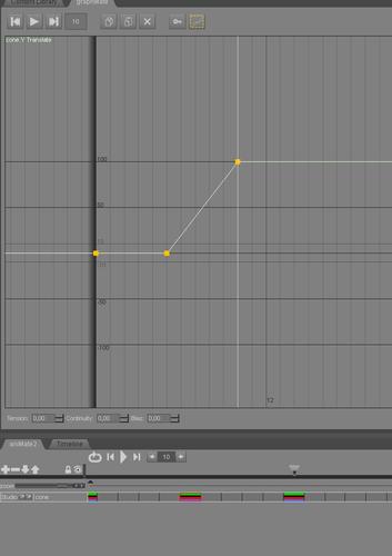

    now look here please
    line1 (right) is default
    line2 has the line changed to linear in graphmate
    803 x 999 - 96K
    713 x 1009 - 90K

  • RuphussRuphuss Posts: 2,631
    as I showed you you can easily do this with "Graphmate" by Gofigure
