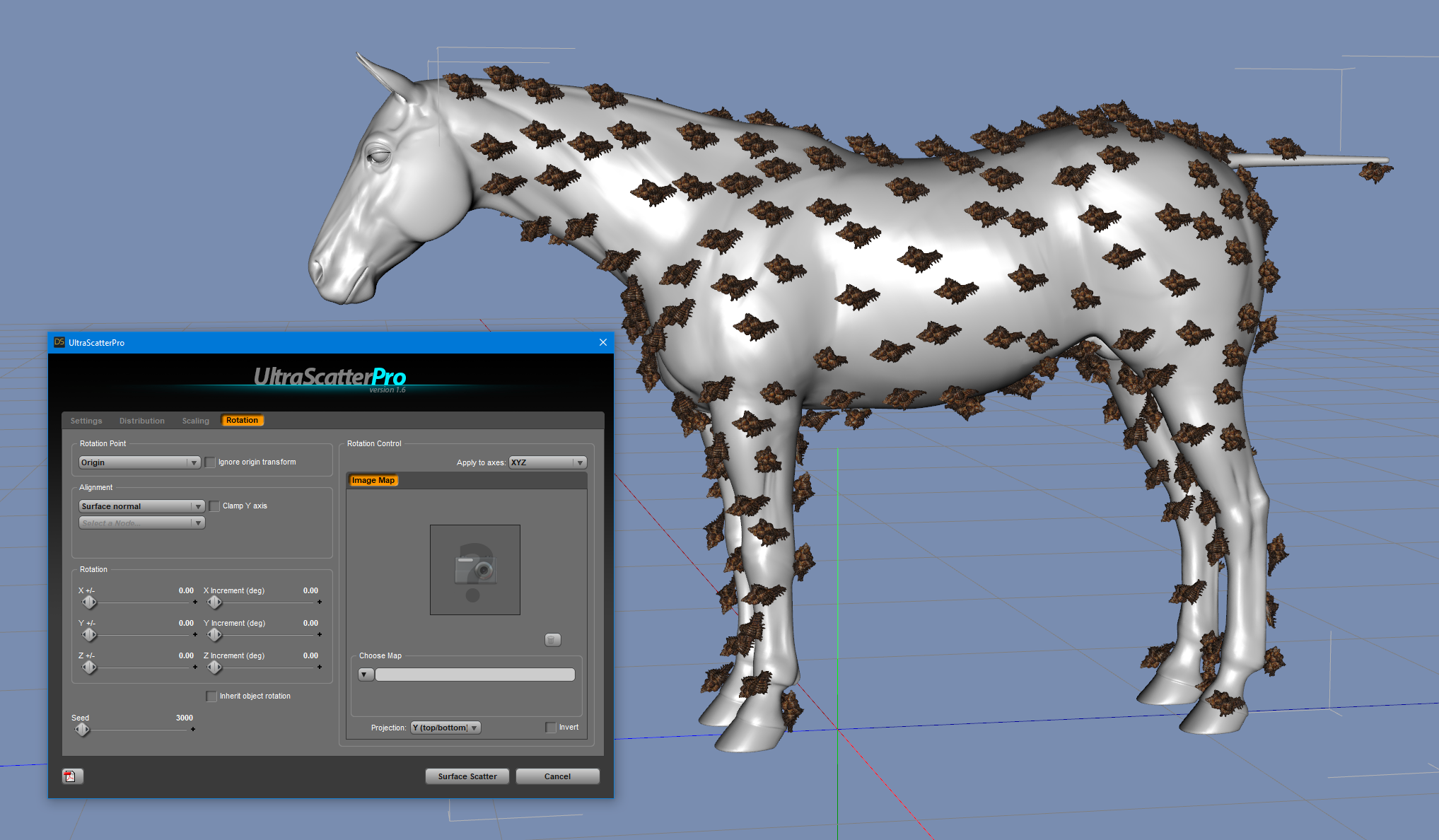

I just recently purchased UltraScatter Pro, and I love it!!  It's very easy to use on things like terrain, and I can think of a thousand different uses for it.
However, I am having some trouble with the settings on my current project.  I want to scatter an object onto the Daz Horse 2's coat.  I have selected the object (a seashell), and made the Target the Daz Horse 2, with the Limit Scatter To set to it's coat.  Good so far.  When I tell it to scatter, though, it rotates the seashell every which way, instead of keeping it flat against the coat.  Could someone help me figure out what settings I need to change to make the seashell scattered laying flat against the coat?  There are so many settings, and I'm afraid I'm rather lost!  I suspect I need to change something in the Rotation tab, but playing around in there hasn't made a different so far.
Thank you for any help!

    Try Alignment Surface Normal

  • Fae3DFae3D Posts: 2,933
    AHA!  That seems to do the trick!  Thank you so much, barbult!
