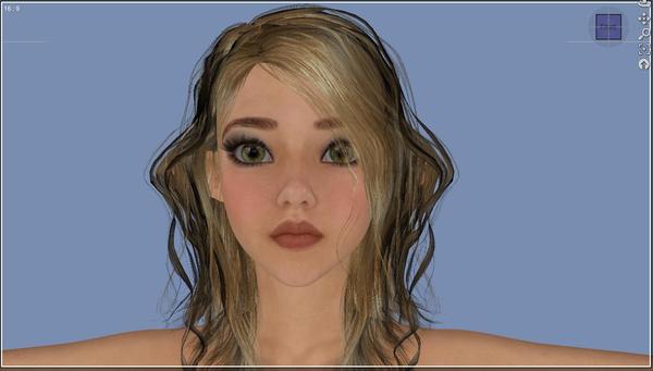

Today's release of Karynna for Aiko 6 has made me think again of an issue I have had for a long time with hair - specifically, I love elf-style ears, but whenever I try to use elf ears, the hair auto-follows and creates really bizarre patterns around the ears. Attached is a screenshot showing this oddity, and this is thankfully not as bad a situation as I have encountered in the past.
I have yet to find a workaround for this in Daz Studio - hopefully others have some ideas on how to deal with this?

  • j cadej cade Posts: 2,310
    If you turn on hidden options under the parameters options, you can select the hair and manually dial down the morph. However, you do still have to deal with any pokethrough.
  • DaWaterRatDaWaterRat Posts: 2,887
    If the Elf Ears are a separate morph, this is very easy.
    Select the hair.
    On the Parameters tab there should be a little spot with 3 or 4 (don't have DAZ open right now) lines on it. Click on that.
    Look for "Show hidden Parameters" - click that so it is checked.
    Now, under "Actor" (usually) you should be able to see the elf ear morph on the hair. slide that to zero.
    And that's it.
    If the Elf Ears are part of the head morph, it's a little trickier, as you need to have a similar elf ear morph available. Dial that to something small (1% is usually enough), and then see the directions above.
    A back issue of DS Creative has a more graphical version of this.
  • WF3DWF3D Posts: 44
    Thanks for the quick response - it works like a charm :-)

    Another option occurs before actually dialing in the ear morphs, if you're using DS.
    Click the gear for properties on the ear morph you wanna use, and uncheck autofollow. Now hats, hair, etc won't follow them!
  • SpitSpit Posts: 2,342
    Thanks very much for the tip. I'd totally absolutely and definitely forgotten this!
  • Tiger Lee ArtsTiger Lee Arts Posts: 44
    Thank you all for this post it helped me a lot.
