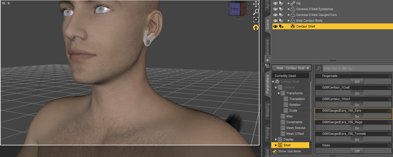

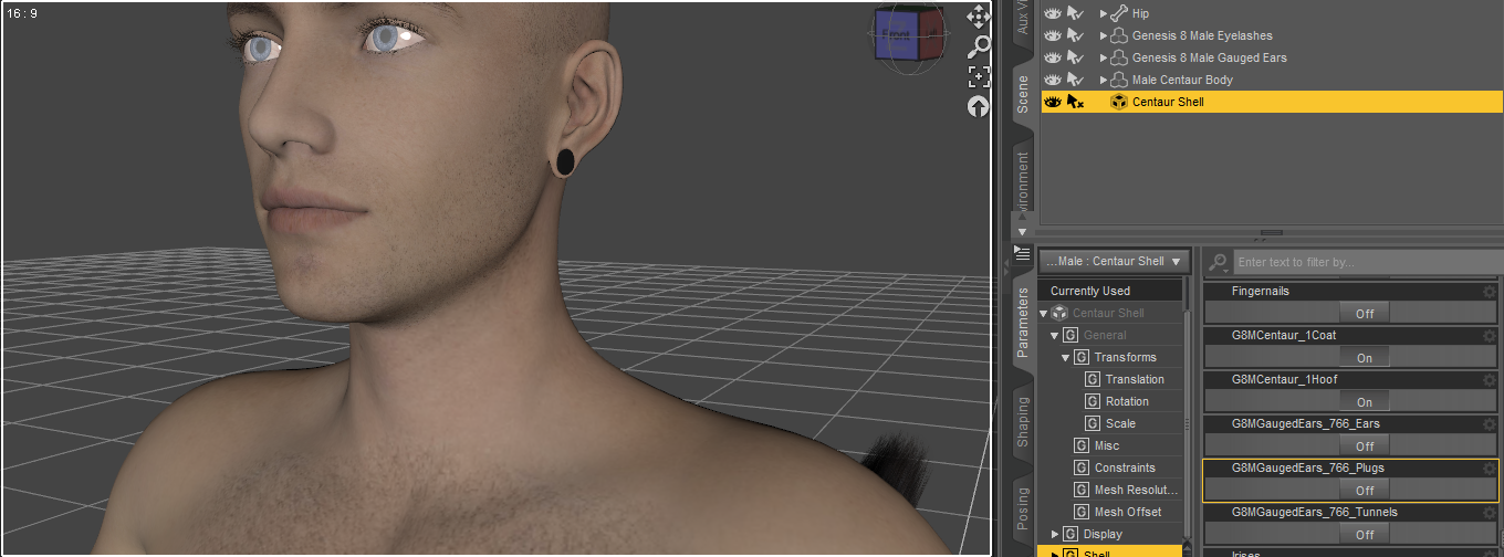

    Here, this will help illustrate.
    Before:
    After:
    1357 x 543 - 481K
    1360 x 504 - 441K
