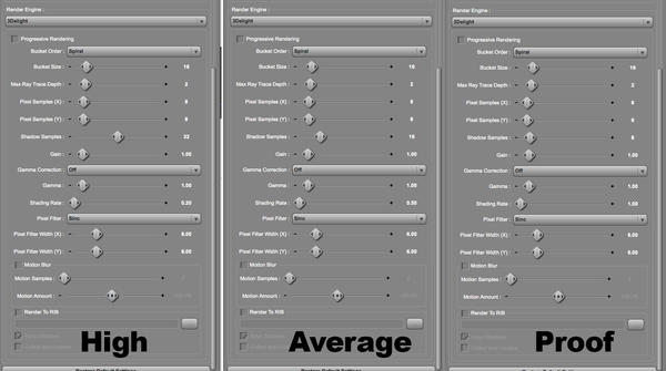

Ok, to begin, I'm using Adamr001's awesome render setting presets.
http://www.daz3d.com/forums/discussion/16085/

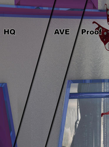

The screen shots tell the story. When I rendered a picture I'm working on, the wall in the background, with a textured chrome ..texture, to my eyes, looks better..more.. textured...in the less render settings. Why is this? I figure this is a teachable moment if someone can maybe explain why the settings are causing these results.
(the pattern shown in the proof looks to be the christmas tree that's in the picture, it repeats across the area in the proof but not in the others..it's smoothed down)
(render times between Proof and High were basically the same, while Average was about two times as much, though I was using the computer during that one, so that data is corrupt)

    It's because of the combination of shading rate and shadow samples.
    And it's not that it looks more textured. That wall has grainy shadows in the proof and they are more smoothed out in the High quality.
    Since you wanted a teachable moment, I guess I'll share what I have learned about renderman settings over the years.

    Shadow Samples
    The higher you set this the less grainy shadows will be, to a point. This should be set like 1,2,4,8,16,32.
    If your system can run modern games no problem you can leave this at 32 and forget about it entirely. Otherwise, if it's a slow system and you need a draft, then set it to like 4 or 8. Note that past 32, you are probably better off fussing with pixel samples or the dreaded pixel filter to smooth out shadows. Also, a lot of advanced lights that you can buy at the store here on Daz3d tend to have shadow samples built into the light itself. So if you have a scene using only those, you can set this to 1 and forget it. Since you will be setting the shadow samples per light.

    Shading Rate
    This has to do with something called micropolygons. Setting this to 1 treats each pixel as if it contained 1 polygon for purposes of light simulation. Setting it lower increases the number of polys per pixel. The real secret of shading rate is you can get away with a smaller number of micro polys with higher resolution images. So small res under 720p should be set to .10 or .20 and 4k res could get away with .50 or higher. Shading rate does have a large impact on image sharpness. So if you think the final render is too blurry then try lowering this setting in .10 increments. Also, if you want a draft render and your Computer is chugging along at 1, there is nothing wrong with setting this to 10 or even 20 to get that draft to actually render in a reasonable amount of time.
