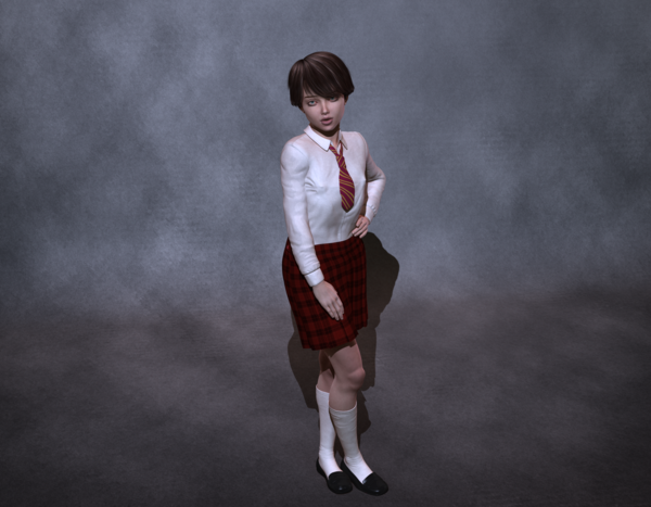

I'm having trouble working with G2F. For some reason, the figure's nipples heavily deform whatever shirt / top is being worn. I have ensured that there are no nipples dialed in to the figure and played with various settings, but I am still getting significant deforming of the shirt. I own several G2F products that add morphs to the chest, including the Clothing Breast Fixes, but none of those address the issue I am seeing here.
In the attached image, I have dialed the nipples to zero, but the shirt still clings in that area in a strange manner. I am having this happen with multiple clothing options.
What am I missing?
Thank you.
1920 x 1495 - 3M

    Thanks for all the replies! I had been checking the Currently Used list, but not seeing any morphs that might be causing this. Then I thought of the character morphs I was using, after being reminded of it here. Sure enough, when I dialed out Domina Body (which was set to 100%) it seemed to solve the problem. No big deal really since I could keep the Domina face morph dialed in.
    I think this looks a bit better in the chest area.
    Thanks everyone!
    1920 x 1495 - 3M
