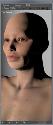

The point to setting in Poser 2014 on V6 eyes aimed at a camera leads to a fracture distortion around the lids when not in straight on camera pose and this gets worse with the rotation because of camera dolly movement.
It seems to be something other than the lids getting fractured. Is it the scelera which seems to be a separate geometry in V^ and not in any other characters I have used?
I deform/morph V6 in DS and then export/import an .obj file (subdivision level 1) in DS - then transfer the rigging from the DS character and adjust rigging to the shape then export to Poser as a CR2. It seems to be a rigging question around the centering of the eyeballs and surrounding geometry.
Does anyone have any ideas what I'm doing wrong or what I need to do to fix this please?

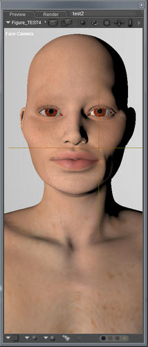

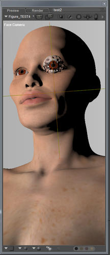

    Here are 3 screen shots of the left eye set to point at face camera (1) front straight on(2) left rotate (3) left rotate and down.

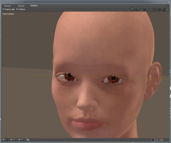

    Better - here is a screen shot of my corrected bones for my custom V6 CR2 - but there is still fracturing of the Scelera? I am only able to guess at positioning of end and center point as when I perform align to shape I go back to the error positioning that came standard with V1 I think you said. Any pointers suggestions - I am learning to use DS purely to get the custom figure set up - apologies for the apparent dumbness on my part.

    Here is a face camera screenshot with point at camera (face) and the polygon shattering/sharding appears better - hardly apparent at low pan/dolly movement - but there seems to be vertex attachment the eyeball geometry. I hope this will give someone an idea on what the cause is?
