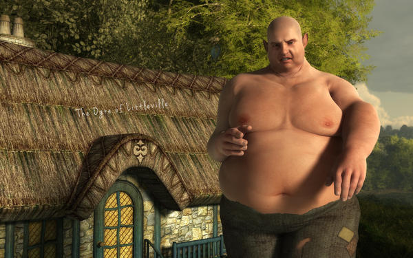

    I am using the exact same setup as I would render with 3Delight. I open up the Reality 4 editor assign the camera to the one I'm viewing through in DAZ and I enable the same lighting in the lightings tab of the Reality editor.
    Here is a render that took 30 minutes (with very small resolution) with the Reality 4 plugin. The other image is the exact same setup but rendered with 3Delight.

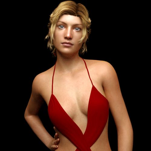

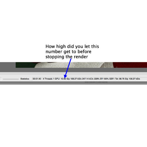

    1st up some general info...
    A typical render done using the Reality 4 plugin can take 4 or more hours before it can start to look as if its done, This of cause depends on your machines specs and what is in the scene.
    for example... with just Vicky 6, 1 item of clothing, hair and a single meshlight on a quad core i5 with 4MB memory and no GPU Acceleration would take as least 2 hrs be for it would even start to look good, now if you where to add some reflective surfaces light a mirror and some glass into the equation then the rendering time could easily triple.
    On a general note you should always allow an image to render until the S/p gets to be at least 1000.
    and now for a few questions,
    Question 1... What type of lighting did you use?
    Question 2... What was the S/p (See screen shot) when you stopped the rendering process?
    Question 3... What Character did you use (V4, V5, V6 etc.).

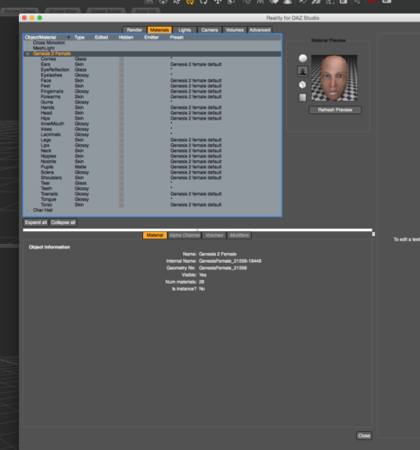

    Thanks for the feedback. I used 1 distant light and the Advanced Ambient Light. I think the SP was around 350-390ish, and I am using Genesis Female 2. All materials were set to Matte except the skin which was set to skin.

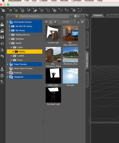

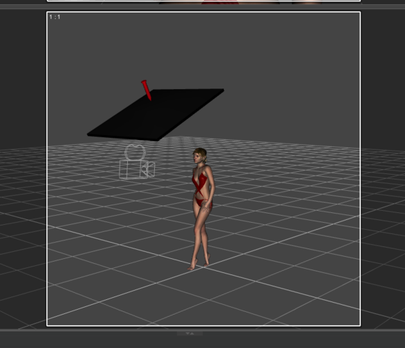

    Ok, 1st things 1st, the Advanced Ambient Light is a 3Delight only light, also try to stay clear of using distance & point lights.
    as JimmyC_2009 said you need to use MeshLights, (i've included a screen shot as to where these can be found within Daz Studio)
    I've also included some other screen shots - 1 of a simple scene with just the Base Genesis 2 Female & 1 MeshLight, 1 of my Reality 4 Material Settings for Genesis 2 and 1 of the Final Render so that you can see the result (stopped rendering at 500 S/p (there is still some render noise around the neck that would disappear over time))

    To create basic Mesh Lights for use within Reality do the following
    1. Create a new Plane
    2. Rename the Plane in the Scene Tab to RealityLight.XXX (replace the XXX with whatever you what your light to be called)
    3. Position the Plane so that the Surface with the Green Arrow is pointing to where you want the light
    Now if you open Reality, your newly created light will appear in the light tab.
    this can be done with all Primitives.
    You can also convert materials to lights within Reality's Material Tab by right clicking on the material and selecting Convert To Light.
    FYI. Callad is in the process of updating her Reality Light System to work the Reality 4.

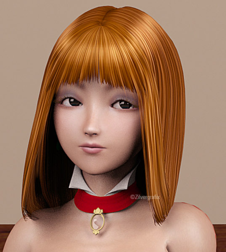

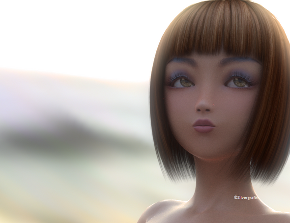

  • ZilvergrafixZilvergrafix Posts: 1,385
    Lights is just one part of the ecuation, don´t forget the material settings!
    535 x 594 - 557K

  • IsazformsIsazforms Posts: 210
    And Where is material settings of Luxus? I can´t find it. I m beninger at all about.
  • PlatnumkPlatnumk Posts: 682
    Are you asking about the Luxus plugin or the Reality plugin?
