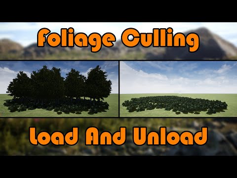

  • * How do you disable LOD so that grass and other objects that are somewhat far away do not disappear?
    I don't know if it's possible to completely disable LOD, but have you adjusted your culling distance? If you're using the unreal foliage edit tool, maybe this video will help? At about 1:40 he talks about culling settings.
