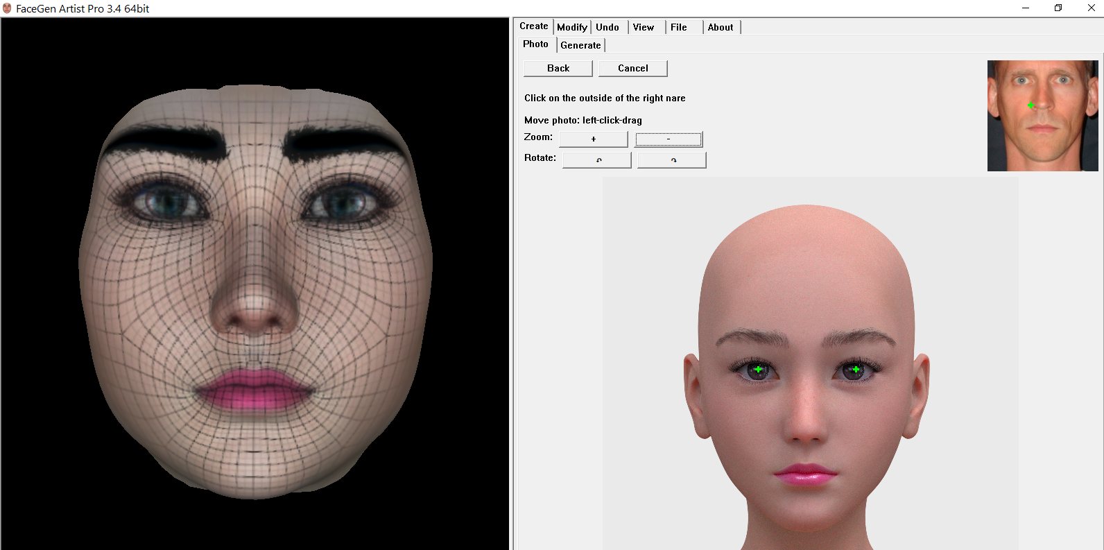

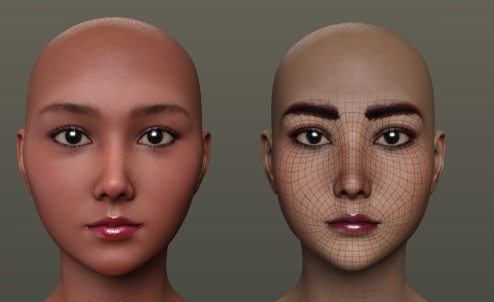

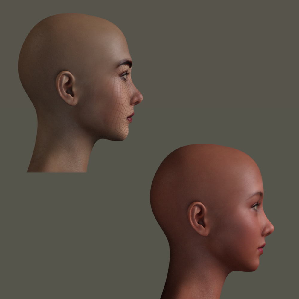

okay here are the 2 more attempts using the additional photos for to try in Facegen.
As somebody with vision problems my little frustration with facegen is that the instruction image is rather small so exactly 'where' one is supposed to put the little "x" is a bit of guesswork which I would hope with tons of experience one would come to know.
With regards to Face Transfer, I have in my tutorial thread quite the topic for swapping out textures so yes one can use one's own textures so Face Transfer can in effect get a starter skin set started. I was cautioned by an experienced Facegen user NOT to try swapping out its textures in this manner as it will goof up the program(s). However Facegen does permit one to select one's own textures in the first place so in the end that part is 6 of one, half dozen of the other.
To note the differences of the head model in Facegen against G8F. ... that is the same result that produced the G8 head in the renders.
{the eyes are a preset from one of the many characters sets we have}
