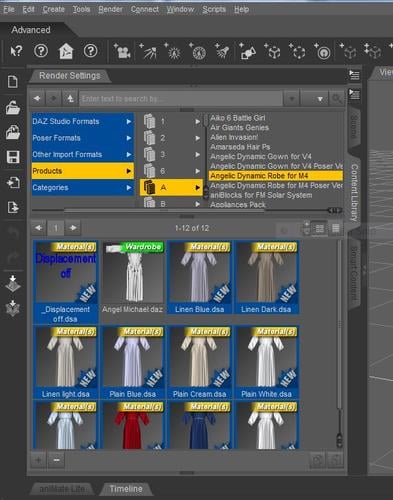

  • jodycourjodycour Posts: 137
    Ok here goes!
    570 x 726 - 85K
  • Richard HaseltineRichard Haseltine Posts: 111,315
    OK, that's the right file, assuming you are loading Angel Michael.daz. Does it appear in the Dynamic Clothing pane if you select it in the scene?
