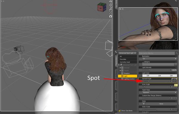

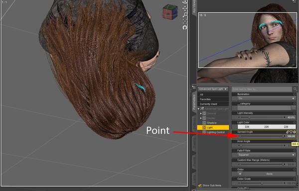

  • SzarkSzark Posts: 10,634
    by reading the manual.... seriously though in the parameters pane there is a setting, I will go and grab a screenshot for you brb
    Spread Angle
    1272 x 812 - 467K
    1272 x 812 - 685K
  • KharmaKharma Posts: 3,214
    so it is dependent on the spread angle of the spotlight...so just by looking at that setting you will know how it is being used? I do not remember seeing that in the AoA manual, but then again lighting is not my friend lol I struggle with it all the time as you would see in my latest post in my thread Kharma's Korner in the Art Studio. Thank you for the info :)
    It is in the Quick Tips section of the manual, but not much is said about it.
    Yeah that is why I followed my post with "seriously" as I was joking. As barbult pointed out the manual requires previous understanding of light parameters hence why I posted screenshots.
