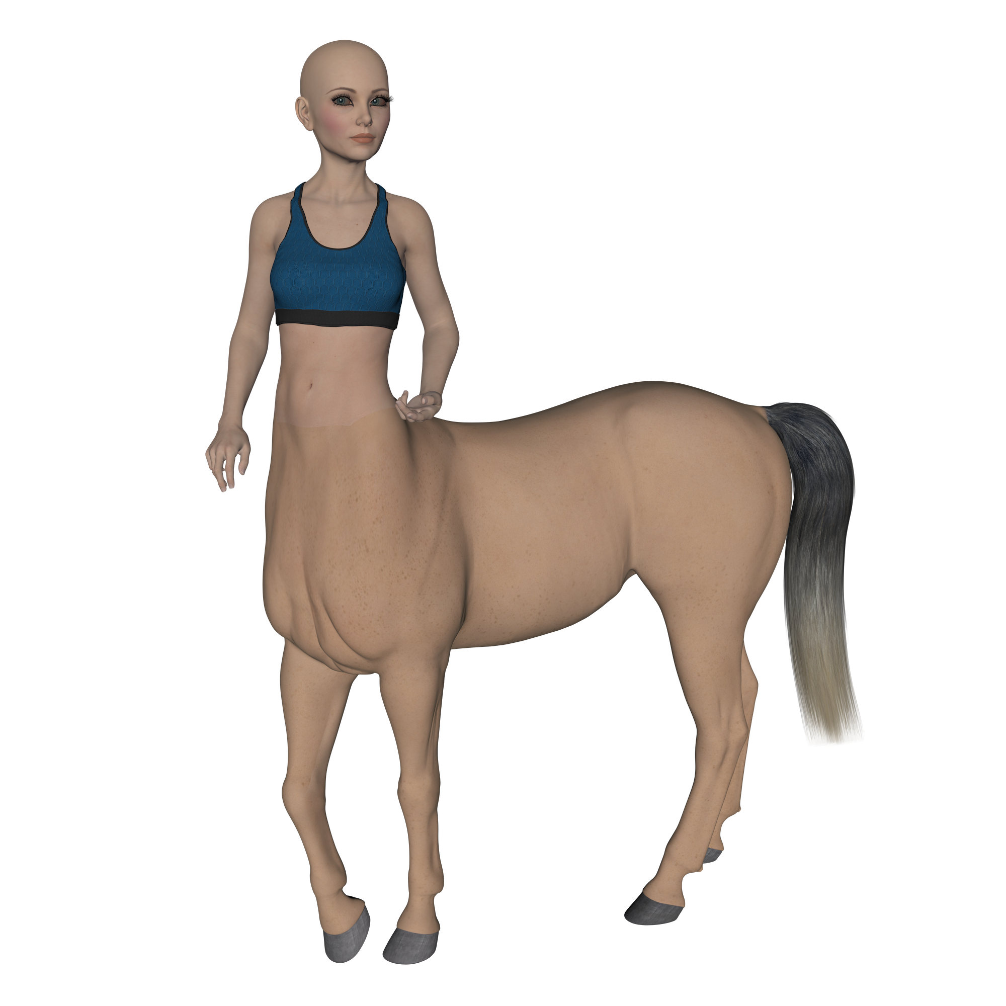

    I used Maxx's body skin on the Female Centaur body Coat with no opacity map ,then put the horse texture map on the Geometry shell on the Coat with the transmap in the opacity slot ,got rid of the opacity in the torso ,then it just took a little smudgeing in GIMP to blend out the seam or you could clone it out .....also I'm usig 3DL , not iRay
    I didn't blend the second one it' just the Centuar body with the Geometry shell turned off
    2000 x 2000 - 2M
    2000 x 2000 - 1M
    Post edited by carrie58 on
