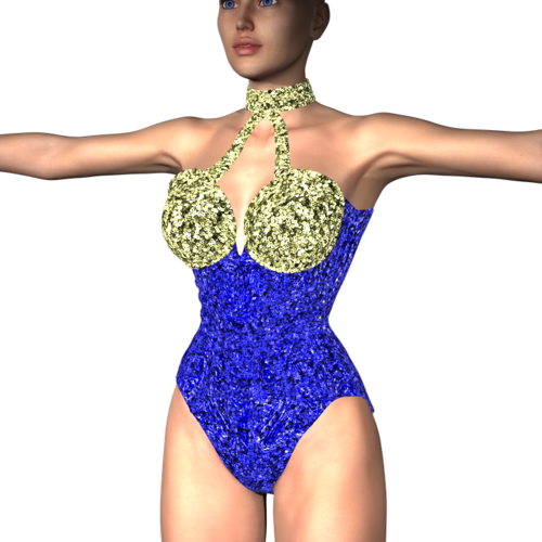

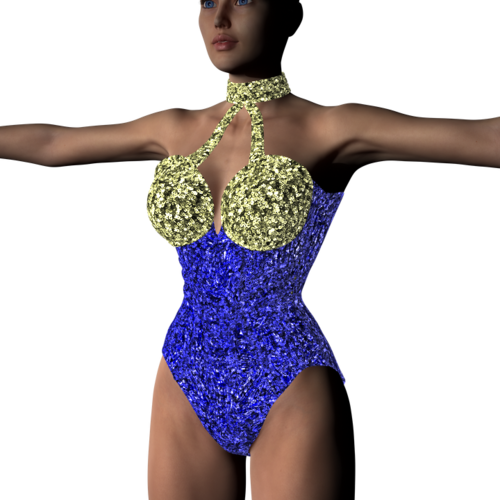

    Not really getting what I want... The reflection I am looking for Needs to be White... any suggestions?

    What kind of lights do you have in the scene? You can add a standard DS distant light or spotlight and set the illumination type to specular only. Then crank up the specular settings on your surface and use a light specular color like maybe light grey. It will probably take a bit of trial and error and many test renders to get the exact look.
    The sequin texture you are using is probably not going to reflect and shine like the ones in reference picture no mater what you do, as your sequins are all overlaping and the ones on the costumes are in flat rows.
    Have you tried Fisty's Sparkles Shader? It might save time over tweaking the surfaces yourself.

    For now I've only tryed one and two Spotlights. This shader is going to be used in a Scene like a Broadway stage, with Spotlights. I already tryed the specular, the reflection... but I haven't tryed the refraction Thing. The reflection I got until now would work fine if it only would be White! But it always turns out the same Color of the Diffuse. That bothers me :-) I'll go on and try for a bit. If nothing works, then I will go for Sparkles for Studio :-) Thanks again for your suggestions! :-)
