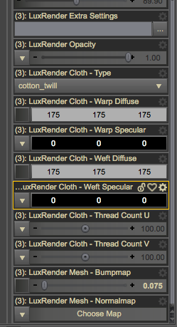

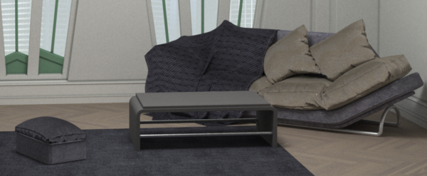

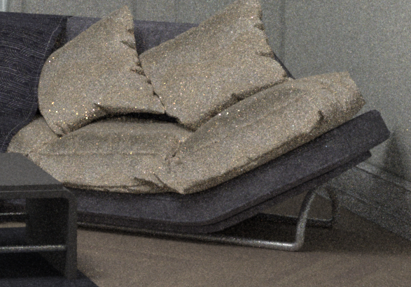

pure white are probably the culprit here. I would tone down the white to 170 ish range
But, actually that bump map value seems very high and could be the problem and probably unnecessary on cloth. Cloth will have a cloth looking texture, is the bumpmap to emboss a logo or something?
Thanks - I wondered about that but I thought that was only an issue for the specularity colour. I'll try again with your suggestion.
I just selected the cloth and copied the DAZ Studio values, so the bump must have been inherited.
Nope -- fireflies still there.
Here are the settings now.
My experience with fire flies is that the lightning is to low.
Use more light sources, like big area lights or a dome, IBL...

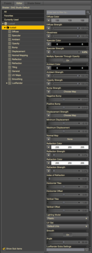

I want using the mesh options in Luxus (bump and displacement).
Unfortunately I cannot find the negative and positive values to set the image scale. There are only the strength value.
How can I set this mesh options?
Is there somewhere that says LuxRender should have a negative and positive value?
Mathematically strength is the scale, although perhaps not as convenient.
Yes, LuxRender need the displacement values in meter.
But I have a gray image or a one channel of a colored image. This means values from 0 to 255.
It is very beneficial to scale the image. For example 0 is - 1mm and 255 is 3mm, like DAZ render.
So I can use the DAZ values and Images (with scaling).
In Blender I use the texture setting for this.

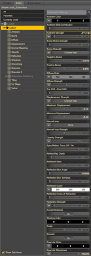

Thanks for the bump info, Dose that imply that I need to change the bump strength from 100% 3delight, to 1000% for Luxus?
how about the "shadow bias" on the lights? or are they combined as the same thing?
I love Spaghetti but only with red sauce.
Bumps: Start with 100 % and if it looks cruel, use smaller values.

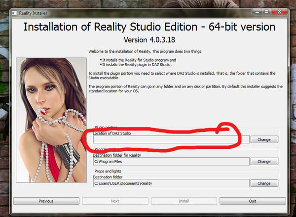

Quick question... is Luxus a dll? DIM says it's installed but I can't find it. Opened up DS and can't find it there either. So kinda strange. Thanks for the help!
Luxus is a dll. You will find it under plugins.
Hmm. Wasn't there but say's it's installed according to DIM. I'll uninstall and reinstall when I get home from work then.
If you right-click on the entry in DIM and choose "Show Installed Files", what does it say?
Just home from work and dinner with friends. OK. ... reinstalled and now Luxus.dll is showing in the plugins folder and the Luxus render option is present in the Render Settings drop down. YAY... lol

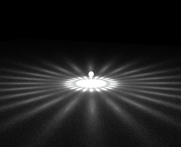

If I may ask. IES lights. I take it they are the preferred method of putting lights into a scene.
Is there a simple, >"Photo Neutral"<, IES light set? one that is NOT scavenged from a light manufacturer, or Product that must be purchased.</p>
My goal is to convert my 'Test Chamber' to Luxus. As a test chamber, it must, >MUST<, use lights that can be access by anyone to use and (in a scientific way) Duplicate the testing environment. The description of my 3delight chamber (And construction instructions) are here.<br /> http://www.daz3d.com/forums/discussion/47738/
Or is that IES stuff not at all what I want?
(EDIT, ops, wrong link. fixed now.)
IIRC, that is pretty much the definition of IES light data — it's released by light manufacturers so that architects designing e.g. a room or a car park can run the numbers for different options and work out what kind of lights they need to buy and how much light goes where in the final design, before they start actually building anything.
I've tried setting up a scene with IES lights a few times, without much success; I think I must be doing something wrong. It's much easier for me to set up mesh or environment lights. They have the advantage of being directly adjustable, whereas with IES data the only way to change the behaviour of the light is to change the data. Not very user-friendly.
