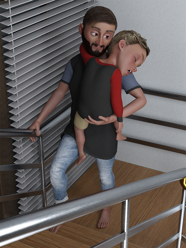

    Here's the same scene, re-rendered at 750x1000 and downscaled from its original resolution (2700x3600) to the same dimensions. I have no idea what happened to the father's eyes in the re-render, but otherwise the two images are illustrative of the difference between the two approaches.
    Re-render
    Downscaled
    750 x 1000 - 1M
    750 x 1000 - 1M
