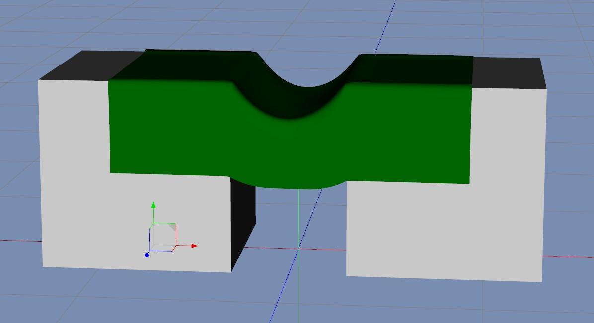

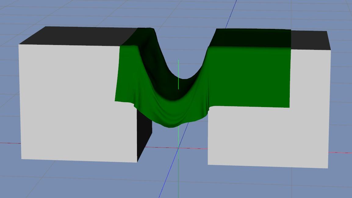

    You may not want the dForce dynamic item to interact exactly the same way with all collision items. Applying a static surface modifier gives you more control over how the dynamic item interacts with the other collision items with regard to friction. Here is a trivial example:
    1) No Static Surface modifier on the cubes. The plane has a Dynamic Surface modifier with default friction setting
    2) Static Surface modifier applied to the cubes. One cube has higher friction setting than the other. The plane has a Dynamic Surface modifier with default friction setting
    1196 x 651 - 47K
    1154 x 651 - 46K
