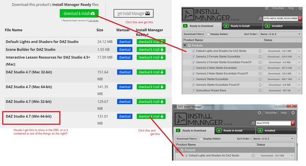

    So I would like to use the DIM to re-install, but I cant seem to get DS4.7 to show, unless it is in something, or I am completely missing it (I did just get my first pair of reading glasses recently)
    Can someone tell me how to queue it in the DIM?
    1403 x 765 - 259K

    OK, it must have been part of the starter essentials...cause I let the top bunch run in the DIM, and after download, when install started, the Daz Studio and PostgreSQL magically appeared and started to install. :) I'll update after its done if it all works.
    Update:
    Well, it appears "hung" as it keeps cycyling through the list shown, and each one fails, then retries and fails and retires and fails, etc, etc, etc... I killed it restarted it, and installed each one, and got through it.
    Seems to be all working now...
