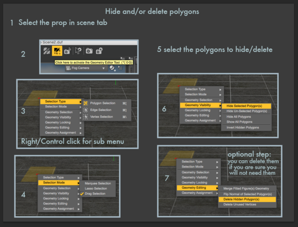

    Then- If the wall is not a separate prop or surface, you can't delete, make it invisible (surface to 0% opacity) , or turn it off you could use the polygon editor tool to select specific polygons and turn them off or delete them.
    1049 x 800 - 679K
