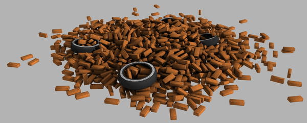

Hello,
I'm playing with Carrara again and the physics engine creating piles of stuff. Yeah, it's fun!
I've found that most items works very well, from bricks and blocks to oil barrels, but one shape really messes it up, tires.
They tend to try to creep tight and stack inside each other until there are only a few, mega tires, lol. They collide great with other things except items of their own breed.
Any good hints?
Attached a sample of what I'm playing with.
1600 x 642 - 146K

  • DUDUDUDU Posts: 1,945
    Age off armour made this tuto: http://www.youtube.com/watch?v=-XGRj4VjPqk
    It is perhaps not what you seek, but it is interesting.
    In the Scene/Physic tab, try to changes Bullet in Standard…
    The collision distance is important too.
    Perhaps place a squashed cylinder primitive in the opening, make it invisible and parented to the tire, and see if the results change? Like a circular plane sitting right in the center?

  • VarselVarsel Posts: 574
    I did a quick test, and I did manage to get it to work.
    -- That is with only 6 tires, and noting else i the scene....
    Under Scene - in the physics tab -
    Simulation Accuracy to a higher value ( I used 1000)
    Collision Distance to a lower value (I used 0 )

  • de3ande3an Posts: 915
    I also tried to duplicate what is shown in your animation, but got realistic looking results. I see none of the erratic jiggling or merging.
    Are you using an older version of Carrara? The physics simulations were not particularly good until the introduction of the Bullet Physics Solver.
    However, using either the Standard or Bullet Physics Solver in the current version of Carrara seems to produce good results even at the default settings.
    If you're getting this jiggly physics animation in the current Carrara release, then something else is wrong.
    The problem seems to be that your tires have a thickness to the walls. If you remove the inner surface, the tires behave properly. But with the inner surface it seem like the physics engine is having trouble differentiating between them and the surfaces become entangled.
    I've tried to duplicate this effect with other shapes, but oddly, I have not been successful. It only seems to occur with the tire shape.
    Pretty weird.
    I've just figured out how to duplicate this issue with a sphere shape
    By creating a sphere and then adding a small thickness, a sphere within a sphere is created.
    If you then bridge the inner and outer spheres by removing a single inner and outer facet and bridge their edges you create a hollow area that is now open to the outside.
    These spheres will tend to cling to each other under a physics simulation.
