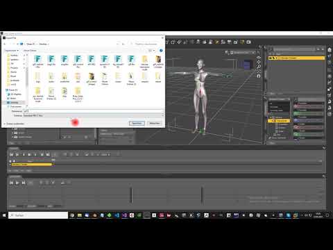

    I have exported the model as an fbx.
    Here is a short video of how I did it:
    Post edited by ForestBoy on
