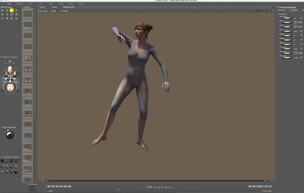

I bought Poser 10 one week ago, I am trying to use Victoria 4.2 with V4 BodySuit.
In the Zero Figure pose the suit match perfect but as soon as I start to create some poses I see Victorias skin trough the suit.
here is a sample: Screenshot_2014-11-29_15.37_.18_.jpg
Please, any info about how to fix this will be very welcome.
Thanks in advance
Diego

    I always magnetise the body suit to V4
  • diego_bbe73e4c67diego_bbe73e4c67 Posts: 0
    Hi, thank you for your answer, I have magnetize it and it works!, I am using "!Magnetize to V4" because the "Magnetize to V4 2" don't works.
    Thanks!
    Diego

    Well I have to say that the problem is solved in 95 % but still in some parts of the animation I can see V4´s Skin through the Bodysuit.
    I am using Motion Capture data maybe this make a difference instead of the key framed poses.
    I finally have removed some V4 polygons in C4D so now nothing is under the Bodysuit :)
    I would like to actually find a real solution to this.
    Thanks.

    in cases where magnetize doesn't work you can use the morph brush to fix poke through issues ( this can be good for when you have layers of clothing as well ). Select the morph brush tool and select some body part of the clothing you want to fix the poke though on ( does not work with the whole body, you need a body part selected, doesn't matter what one, hip, chest, what ever ). on the brush tablet select tighten, set goal to the figure that is wearing the clothes, set poke through margin to 0.001 ( i find this works best ) then brush over the clothing and watch the poke through vanish.
    Hi, thank you very much for your inputs, I have learned a lot last three days, I finally fixed it using Bodysuit Adjustment dials "LoosenFrtPit" L&R.
